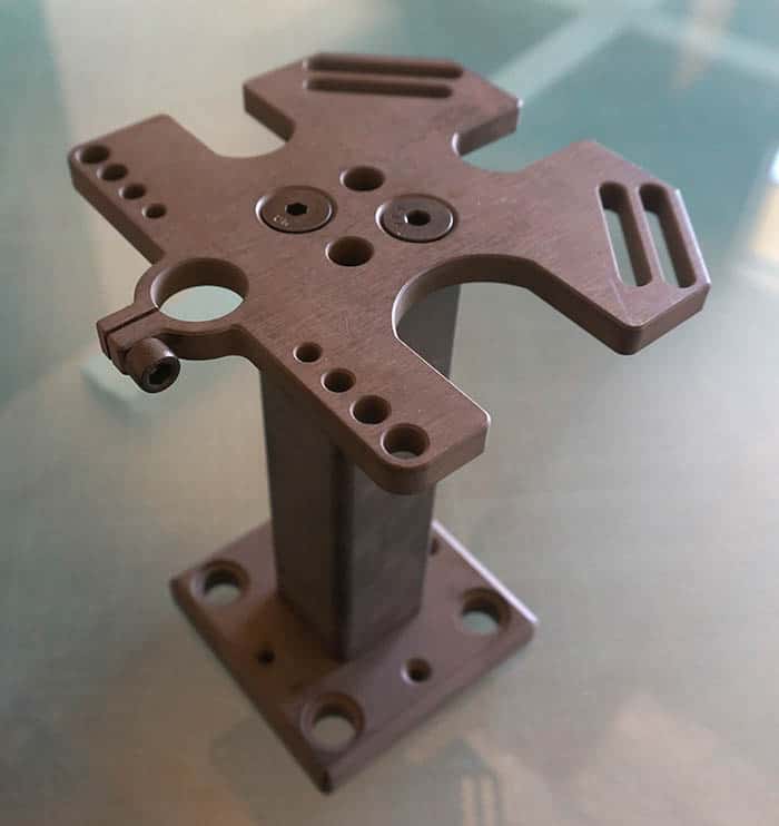

I've  got a fair few products to review in my backlog, so I'm going to try to get these out to you every week or two until I am caught up.  This week, I've got Tosa Tool's (Dan Bye's company) TTS Compatible Tool Mount.  It's an ER Collet Chuck Tightening Fixture.  In fact, both of those names are a little too pedestrian for this device because it is nothing short of a complete TTS ER Collet Workstation.
Here's what the little beastie looks like all assembled on my dining room table:
The TTS Compatible Tool Mount has a durable-looking oxide finish...
Like all of Tosa's products, the TTS Compatible Tool Mount is extremely high qualilty.  It's made from 4140 Pre-Hard, which means excellent durability and resistance to scratches and nicks.  It has a good-looking Black Oxide finish to resist rust and corrosion.  But most importantly, every square inch is covered with useful functions.

I have all 3 sizes of ER collet chuck on hand and the fit for each was excellent:
Industrial drill bit on metal base with cylindrical protrusion against blurred background.
All three ER Collet sizes are taken care of very nicely...
You can mount the Tightening System to your workbench.  I have mine right next to my height gage and surface plate for a complete TTS tool setup solution.  Dan Bye advises you can also bolt it down to the table on your machine, which might also be pretty handy.
I did manage to find one ER Collet that didn't fit, but I don't think this is an issue with Tosa.  It's a cheap Chinese knock-off of the TTS holders and the wrench flat wasn't thick enough to go on the fixture.  Considering the thickness of the fixture, I suspect a lot of wrenches you'd want to use to tighten it without a fixture won't fit either.  This particular collet chuck also came without a collet nut.  Not sure what the deal is with it, but all the other collet chucks from the same manufacturer (and they were all supposed to be the same thing so I am guess this one is defective) fit just fine.

I've seen a lot of tightening fixtures before, but nothing like this.  That's why I call it a "Tightening Workstation."  With all the nifty slots for keys and so on, it's puts everything you need for your task right at your fingertips in true Lean Manufacturing fashion.
A tool this good has to have been a labor of love for its creator, Dan Bye.  I haven't heard this from Dan, but I am guessing he made his dream tool for his own use and then decided to offer it to his customers too.
I know I love mine because it solves an annoying problem-trying to use two wrenches to tighten the darn collet chuck-very elegantly.  You know what I mean if you use the two wrenches and have no tightening fixture.  You'll wish you had three arms and you'll curse every time you can get enough leverage or the wrench slips off.
