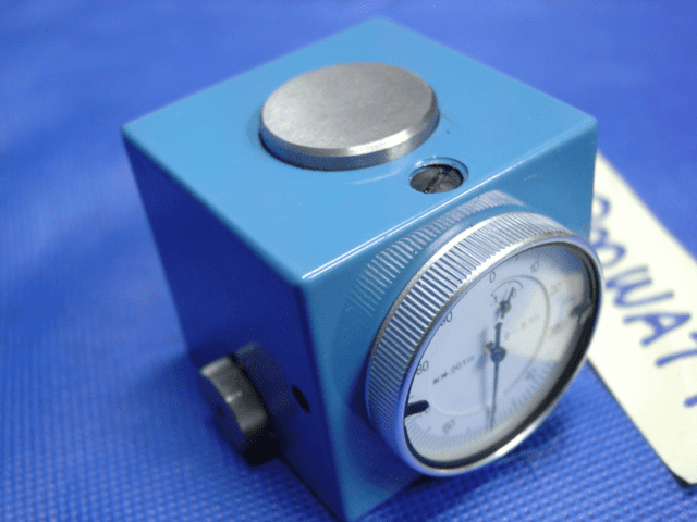

11.   Z-Presetter.  You need some way to set your tool heights.
