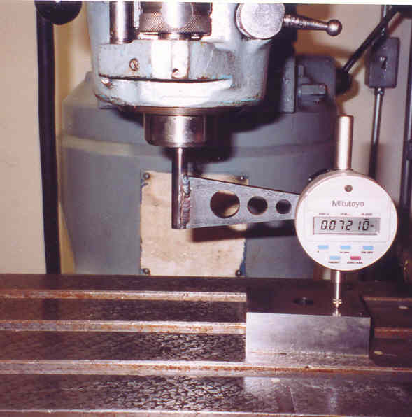

Tramming a Mill With a Traminator (Tramming Indicator, spindle square, or Gage)
Tramming is an important and frequent task for any milling machine whose head will swivel. Each time I check tram on my Industrial Hobbies RF-45 style mill it always needs a little tweak. These mills can be a little bit twitchy to tram because the head is very heavy, wants to “nod” forward as you loosen the tramming lock bolts, and once loose, it is hard to move just a little bit. As you tighten back up, it will typically move a little as well. Since it is hard to move, I have typically used a prybar stuck in one of the holes to gain a little leverage from which to tap the head gently into tram. I use a “traminator” double indicator tool to measure the tram:
tramming a mill indicator
A typical “Traminator” dual gauge tramming indicator available from Amazon
It’s not hard to tram the mill this way, but it certainly doesn’t seem a very precision approach and can be a bit trial and error. At least I can see clearly what’s going on with both indicators. These indicators are relative reading. Set the thing down on the table and turn the dials to zero the indicators. Stick it in the spindle. You mission is to get the needles back to the zeroed position by tapping the head one way or the other.

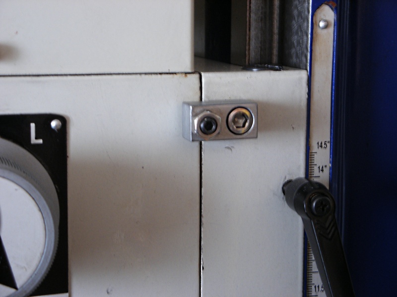

A Fine Tram Adjustment for Your Milling Machine
Having trouble tapping that head in just right? You could always make a fine tram adjustment for your mill.
Screw adjustment makes it easier to precisely move RF-45 spindle head to achieve tram…

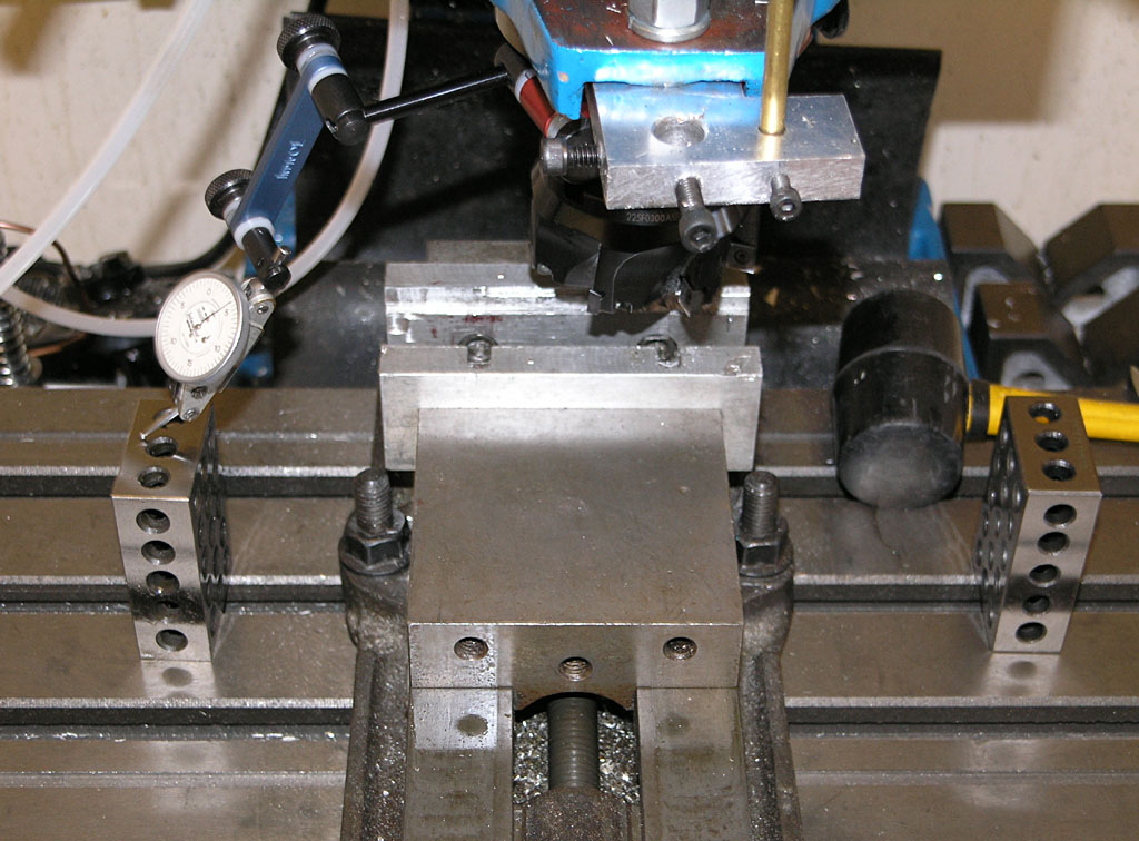

At some point, I developed a procedure that I find easier and faster on my manual mill. This was before I got the Traminator, and I quit doing things this way once I had one. But, for those without a Traminator, here is my basic setup with the DTI on my Indicol and a couple of 1-2-3 blocks to provide clearance over the vise:
Basic tramming
setup…
The goal is to have the DTI have the same reading on either side, indicating the spindle is square with respect to the table. The Indicol is not the best tramming setup, BTW. A proper tramming bar would be more rigid and less “jumpy”. For example:
Here’s a nice
tramming bar that goes in a collet…

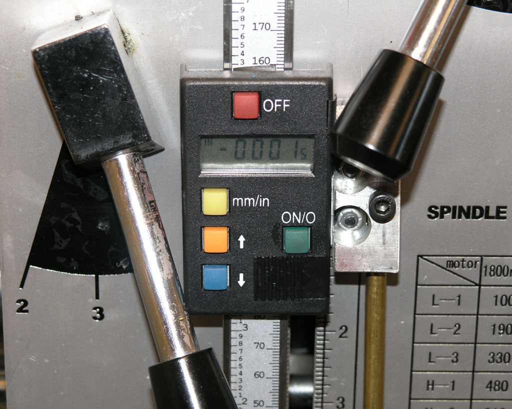

I decided to try using my quill DRO and the DTI like a sensitive height gage to act as a spindle squaring device. I would raise the DTI off the 1-2-3 block on one side, lower the quill until I saw DTI motion, and press the zero on the quill DRO. Then I raise up off the block, flip it around to the other block, and lower down until the DTI registers. Now I can read on the quill DRO the difference between the two sides. Next I bump the head in until the Quill DRO/”Height Gage” reading is 1/2 what it started out. Repeat the procedure until you’re within acceptible limits. I was able to get pretty close in 2 cycles of this:
Head is now
trammed within 0.001″ on about a 10-12″ circle. That’s pretty
close!

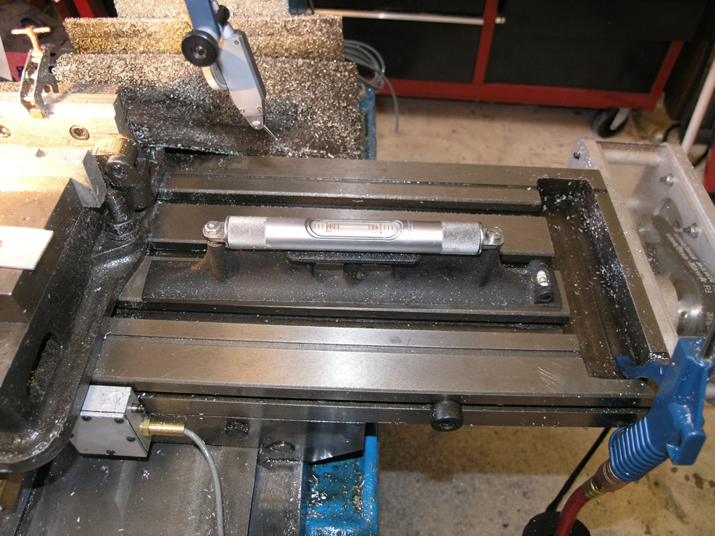

Squaring the Column on my IH Mill
Before I attempted to square my mill, I leveled the machine to the table. I measured my squareness before and after leveling and the difference was substantial. So substantial that you can probably get perfectly square just by tweaking the leveling feet of your mill (perhaps out of actual level but until your machine is square), just like with a lathe and just as Tormach’s Greg Jackson says.
Before attempting
to square the column, be sure to level the table!

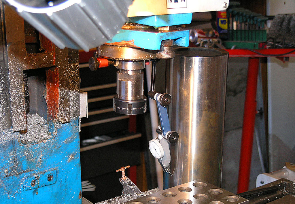

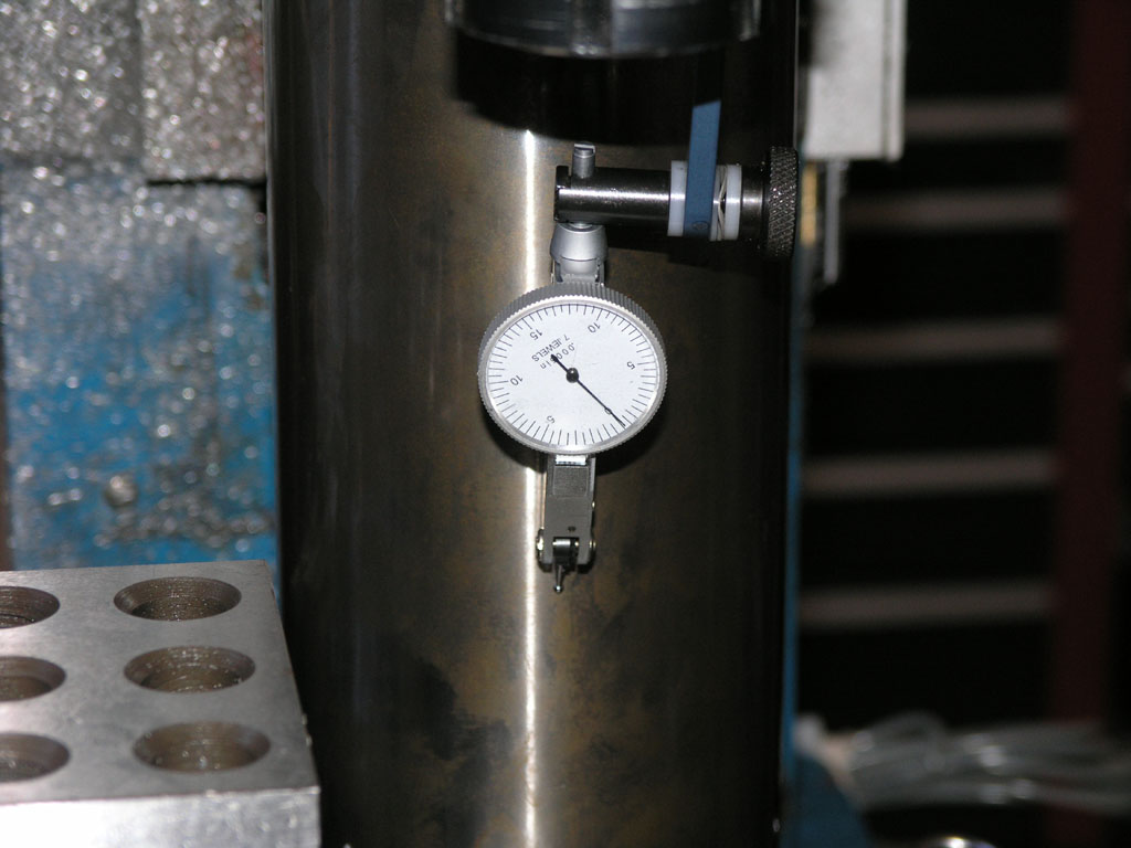

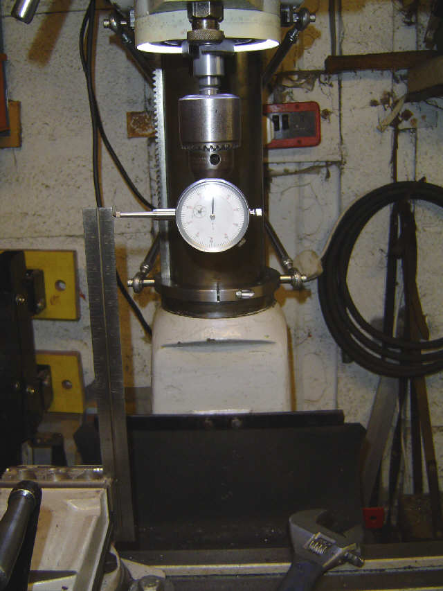

The easy way to check squareness is with a dial test indicator in the spindle, and a cylindrical square on the table. You need to measure 2 planes corresponding to X and Y, so I positioned the cylindrical square twice:
Cylindrical
square is inline to measure whether the column “nods” forward
or backwards from vertical. The indicator should stay put as the head
jogs up and down…
I started at
the top and went down 8″. The need barely moved a tenth!
Now we rotate
90 degrees and we’re going to check whether the column leans left or right
by moving the head up and down and checking against the square…
I was out about 1 thou left to right and nearly 3 thou of “nod” forward. This was easily fixed with a little shim stock. Having squared the head, I went on to tram it as well.
