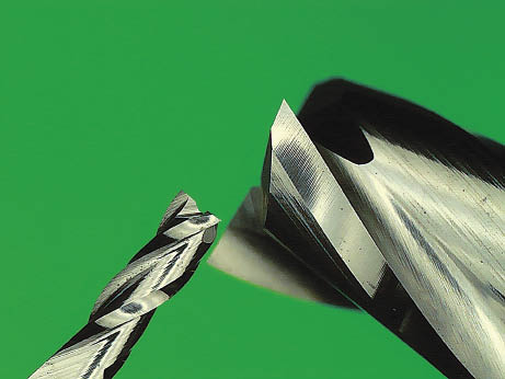

1. Buy Some Decent Cutters
Don’t get the package of assorted sizes of cheezy imported cutters. You also don’t need the solid green unobtanium aerospace cutters from Men-In-Black-Cutter-Supply. Get some decent cutters from a reliable source that has reasonable prices. I like Lakeshore Carbide for example. Try for a name brand, one that’s on sale.
If you don’t know what the good brands are, check out our End Mill survey. It’ll show you which brands are most popular and have the highest customer satisfaction.
Get yourself a few sizes:
– 1/2″
– 1/4″
– 3/16″
Nothing smaller at this stage until you’ve learned on less delicate cutters. Buy 2 or 3 flutes for aluminum and some 4 flutes for everything else. I’d get 3 of each in each size to start. You are going to break some cutters, so get over it and accept the idea. It’s a good thing at this stage to remind you to wear your safety glasses because you will break some cutters!

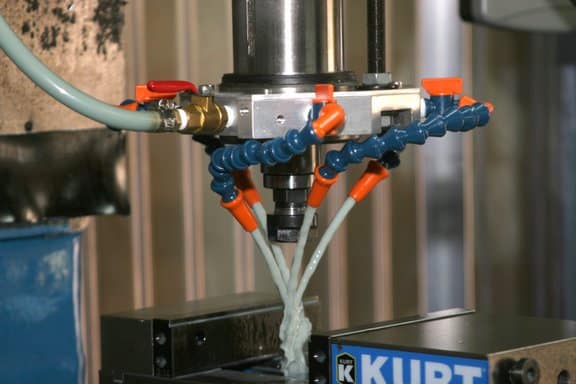

3. Get yourself a misting setup for coolant and use it while being paranoid about chip buildup
If your machine didn’t come with flood coolant, and isn’t set up for it (i.e. you don’t have an enclosure to keep the wet inside), get yourself a misting setup. I got mine off eBay for about $100. It’s a Noga. There are a lot of different brands. Get a jug of coolant to go with it. I use KoolMist, but again, there are a lot of brands.
Now train yourself to be paranoid about chip buildup.
Recutting chips is bad for cutters and in the worst case leads to breakage. Being paranoid means you’re watching the cut like a hawk and you fiddle with your mister’s nozzle until you figure out how to position it right the first time and every time thereafter to blow away the chips from the cut. Learn more about the different CNC Coolant options.
If you’re a CNC Router user, the story is different, unless you plan to cut a lot of aluminum. If you’re cutting aluminum, you still need a misting system. Otherwise, a ShopVac or even just blowing the chips out of the way with compressed air will serve as you cut wood or plastics.

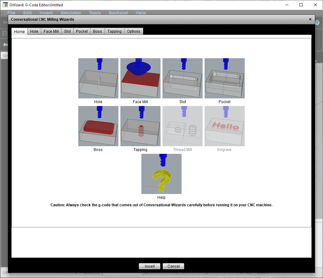

Bonus: Delay the need for CAD/CAM a little while with Conversational CNC
Many talented manual machinists run afoul of CADCAM and it stalls their ability to be productive on CNC machines quickly. Even after they’ve learned CADCAM, they’re still left with the feeling that manual machining can make simple parts faster than CNC, because they don’t have to stop to make a CAD drawing and run it through the CAM package to get g-code.
Instead, they can just make a simple bracket with 4 holes shooting from the hip.
Conversational CNC makes it possible to do that with a CNC machine. Imagine changing the long essay test that is CADCAM to a quick multiple-choice quiz. That’s what Conversational CNC is all about. Here’s the pictorial menu of Conversational CNC operations that can be performed on a mill:
You pick the operation, a popup asks a few simple questions, you press the Insert button, and you’ve got your g-code. We’ve built Conversational CNC right into our G-Wizard Editor product so you won’t have to purchase an expensive stand alone Conversational package.
You’ll still need to learn CADCAM, but with Conversational CNC you can be making simple parts before finishing the CADCAM learning curve.
