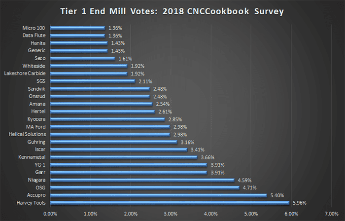

First Tier End Mill Brands
Collectively, this tier garnered 70% of the votes, so they have most of the market share for this audience.
Here is how you voted for these end mills:
Horizontal bar chart showing CNCCookbook.com 2018 survey results for Tier 1 End Mill manufacturers.
The top 3 brands were Harvey Tools, Accupro, and OSG.  Compared to last year, OSG moved up to replace Niagara.  It had been #4 in 2017 while Niagara was #3.

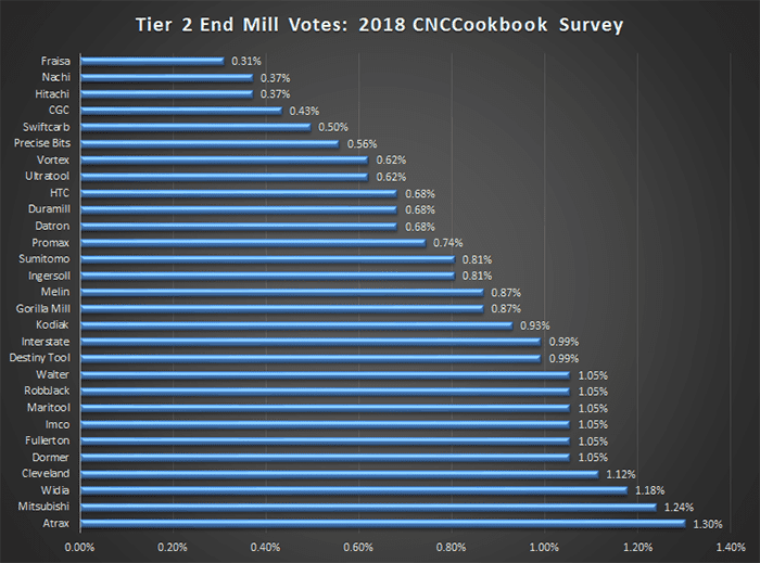

Second Tier End Mill Brands
Collectively, the second tier garnered another 25% of the votes, which brings the total market share of First and Second Tier to 95%.
Tier 2 End Mill survey results graph.
There are a lot of great brands in the second tier.
The remaining 5%, representing the Third Tier, had 62 brands, most of which garnered just 1 vote.  That's too little participation to give us any statistically significant trends.

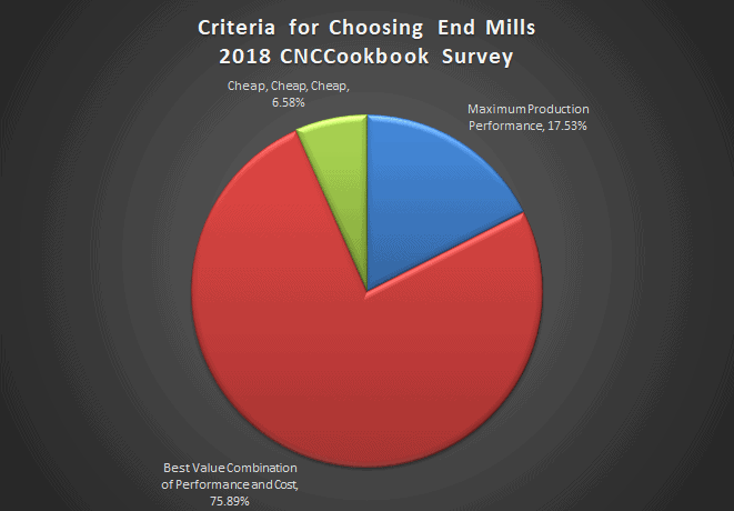

Why are You Buying?
Obviously just straight up brand popularity doesn’t tell the whole story on which end mills might be worth looking into.  We also asked the survey respondents why they were buying with 3 choices:
Here’s the result:
Survey results: End mill selection criteria by CNCCookbook.com in 2018.
The most popular category by far was choosing end mills with the best value combination of performance vs cost.  That was followed by a smaller audience seeking maximum production performance.

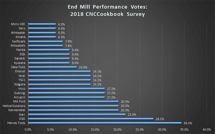

Performance End Mills
Which end mills are the high performance crowd selecting?
Machining tools and equipment, End Mill Performance chart, CNCCookbook.com survey results.
The most popular brands for all-out performance were Harvey Tools, OSG, and Garr.  These were followed by Kennametal, Helical Solutions, and MA Ford.

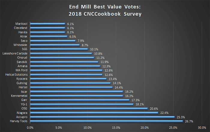

Best Combination of Performance and Price
For our most popular category, folks are trying to balance performance versus price.  They want the best end mill value for their money, in other words.  Here are the results:
Horizontal bar graph showing End Mill Best Value Vote percentages.
The best end mill values were from Harvey Tools, Accupro (MSC's house brand) and Niagara.

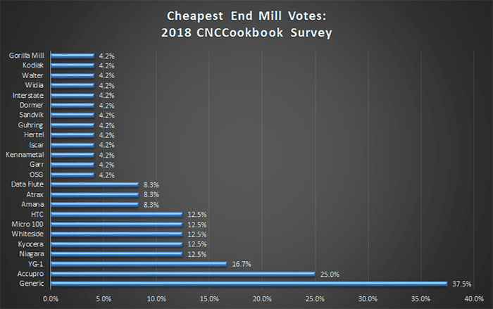

Cheapskates
Hey, what if you just want the cheapest possible end mills, even when it may mean compromising performance or quality?
Listen, sometimes it makes sense.  Here's the brands you choose for this category:
Cheapest End Mill Votes: 2018 CNCCookbook Survey results in blue bars on dark gray background.
It's fascinating to see some of the same end mill brands doing well here as did well on Value or Performance.  Does that make sense?
It all depends on how you define "Cheap".  If it's literally the unit cost of an endmill being lowest, then it makes no sense.  But, if it is the cheapest cost to remove say a cubic inch of material, then it makes perfect sense to see some end mills from the higher performance categories showing up.  I have heard informally, for example, that YG-1 end mills do a great job at their price point.
And of course, it makes sense that the Generic end mills from China win the category by a wide margin.

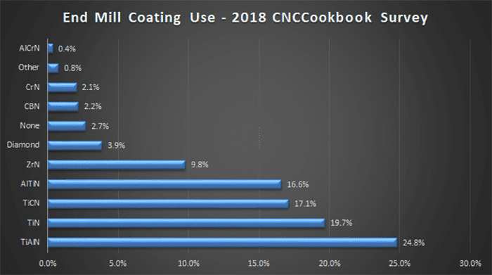

Coatings
The last question we asked on our survey was which tool coatings you prefer to purchase.  Coatings can increase the performance of end mills considerably in terms of Tool Life and Material Removal Rates, so it's no surprise that coatings are very popular.  Here are your choices:
End mill coating usage statistics from CNCCookbook.com survey in 2018.
Only 2.7% of responses prefer no coatings.  The most popular coatings are TiAlN, TiN, and TiCN.
