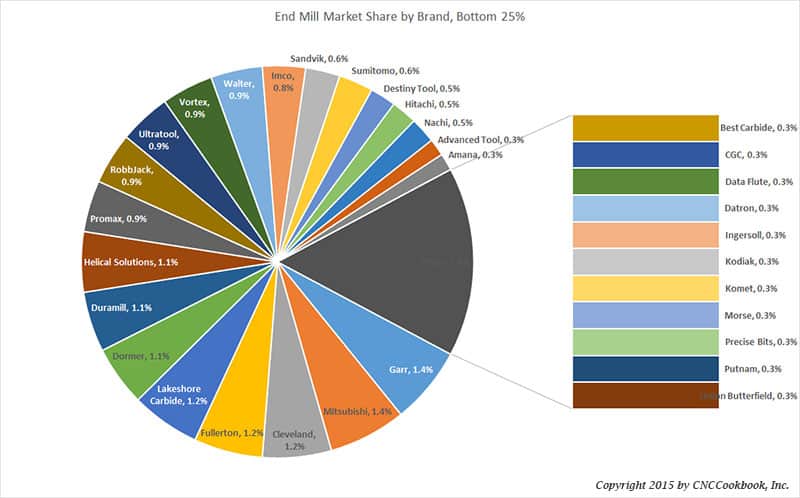

Minor Brands
The remaining 25% of votes were cast for the following brands:
These brands account for the remaining 25% of votes…
