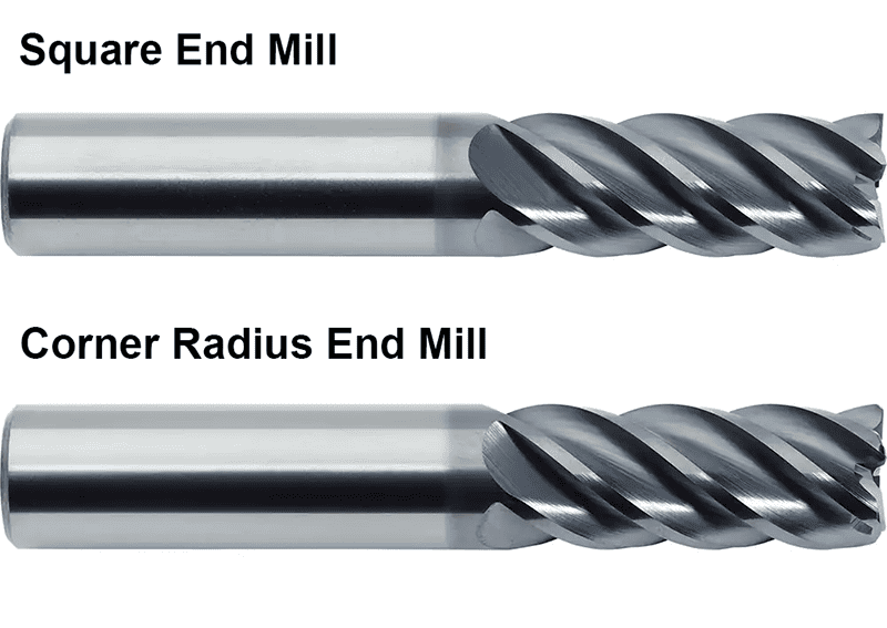

Square End Mill vs Corner Radius End Mill
Square end mills are cutting tools designed explicitly for milling applications, featuring a square nose that creates flat-surfaced cuts with perfect 90° corners in the workpiece. Commonly constructed from high-speed steel or carbide, these end mills are produced by various reputable manufacturers such as Sandvik, Seco, Widia, Kennametal, and OSG Inc.

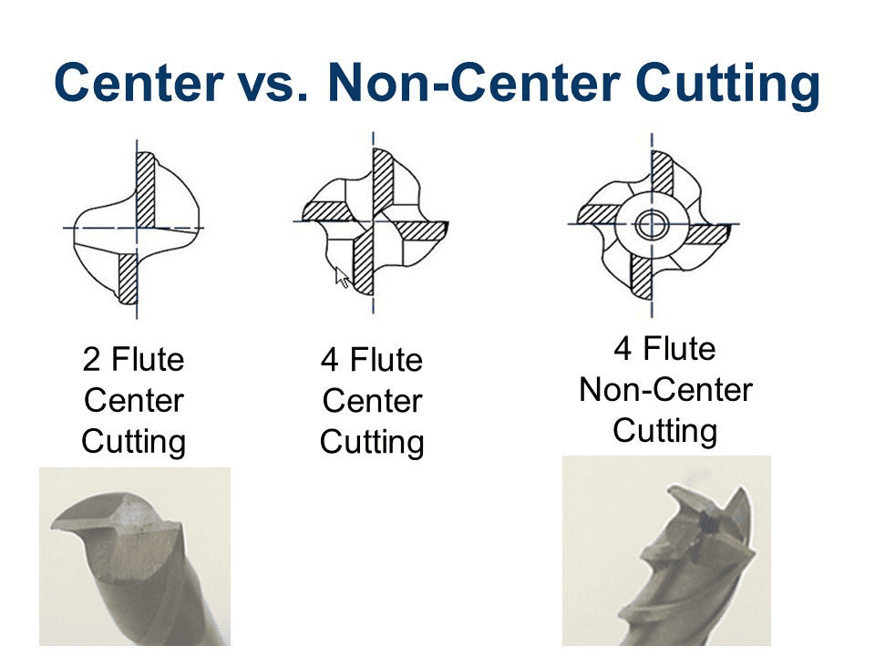

Flat vs Center Cutting
center cutting vs non-center cutting end mills
Another important aspect to consider when choosing square end mills is whether they are flat or center cutting. Flat end mills can be center cutting or non-center cutting. Center cutting end mills possess cutting edges on both the end face of the cutter and the sides, which are indispensable for plunge milling. Non-center cutting end mills possess cutting edges only on the sides and are utilized solely for side milling.
When it comes to applications, flat end mills are generally employed for side milling, while center cutting end mills are utilized for plunge milling. Understanding the differences between these cutting types and their applications will help you select the right square end mill for your specific milling needs.

What is the difference between square and corner radius end mill?
A corner radius end mill cutter has a stronger milling edge than a square end mill, allowing for higher feed rates, longer tool life, and greater productivity when used for mold profiling applications. This makes it an ideal choice for machining complex shapes and contours in a variety of materials. It is also well-suited for creating intricate details and finishing operations.
