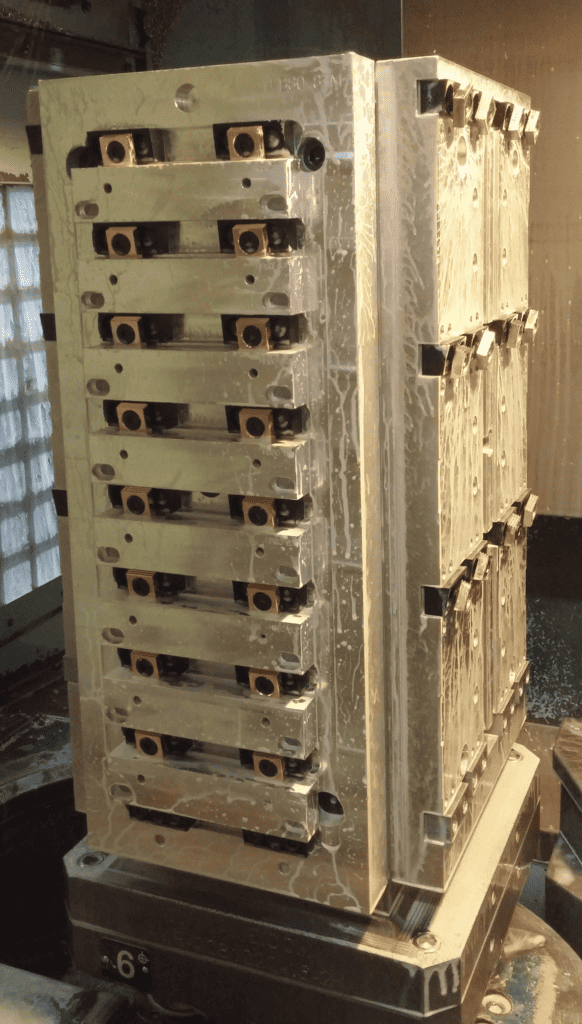

toe clamps holding parts on a machine table
Toe clamps are highly versatile clamping devices made of steel that securely hold workpieces in place, thereby preventing movement during machining operations. They are designed to prevent workpieces from shifting or moving when placed on the side of a table. One of the advantages of utilizing edge and toe clamps is that they permit affixing a workpiece along its sides while still leaving it accessible for measuring, cutting, drilling, and more.

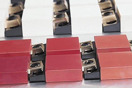

t-slot toe clamps
T-Slot and Edge Clamps are the two primary types of toe clamps. T-slot toe clamps are specifically engineered to fit into the t-slots of machine tables, whereas toe clamps securely hold the side of the piece with considerable positive downforce without obstructing the area. To help you choose the right toe clamp for your needs, let’s delve deeper into the features and benefits of T-Slot and Edge Clamps.
By understanding the distinct differences between these two types of clamps, you can make an informed decision on which one best suits your project requirements and preferences. Now, let’s take a closer look at each type.
T-Slot Toe Clamps
The T-Slot Toe Clamp is a clamp designed to be used in the T-slots of machine tables. This can be done while keeping a low profile so the entire top of the workpiece is accessible for machining. The clamping element has two surfaces: one that is a smooth surface for machined workpieces and another that is a serrated clamping surface for rougher work. This ensures the reliable holding of different types of components. The clamping force of T-Slot Toe Clamps ensures strong and secure clamping of your workpiece.

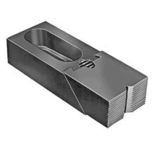

Edge clamps, also known as side clamps, are clamping devices utilized to firmly secure workpieces along the edges. They are specially designed to hold materials in place during woodworking, metalworking, or other fabrication processes. Edge clamps usually feature a serrated jaw that slides at a 45-degree angle to adapt to different workpiece sizes and ensure a secure grip. They are regularly employed when clamping trim to the edge of a large piece of plywood or when cutting large sheets of material.
Edge clamps are available in several shapes and sizes, including straight-edge, corner, and adjustable clamps. They offer a low-profile and discreet clamping option, making them ideal for situations where space is limited. With this knowledge, you can now make an informed decision when selecting the right edge clamp for your particular application.

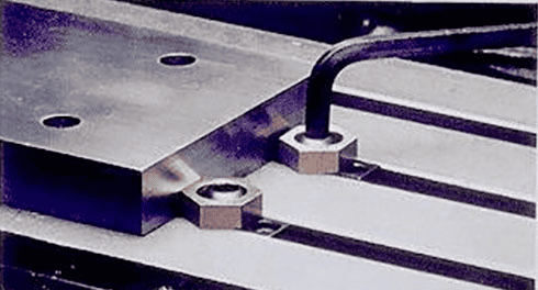

mitee bite toe clamps
Choosing the right toe clamp for your project is a crucial step in ensuring a successful outcome. By now, you should have a solid understanding of the various types of toe clamps and their applications. However, selecting the most suitable toe clamp for your specific needs requires you to evaluate your project requirements and compare different toe clamp models.
