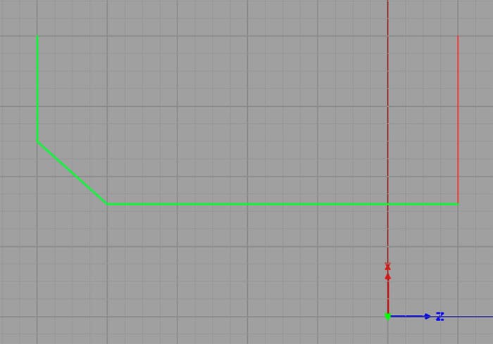

Here is a very simple profile:
A simple profile consisting of 3 G01 segments with a G00 to the starting point…
This profile consists of 3 G01 line segments with a G00 rapid move to the starting point of the profile. The code associated with the profile is trivial:
N1 G0 X1.6
N2 G1 Z-4.0
N3 X2.5 Z-5.0
N4 G1 X4
