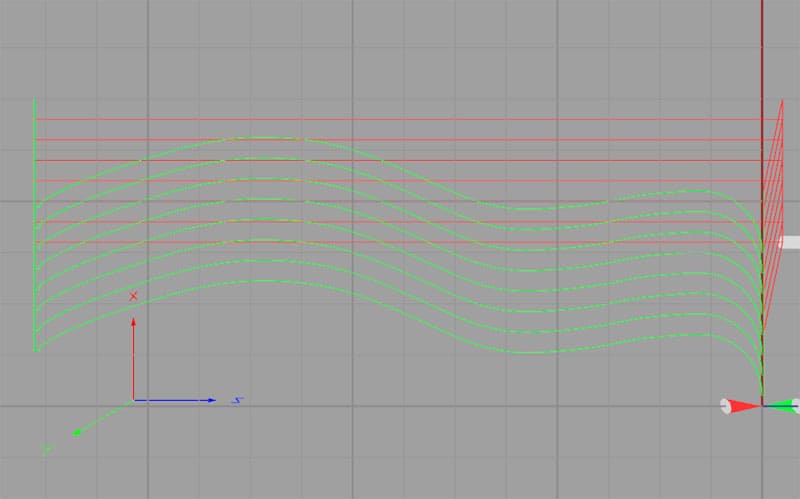

Here’s a sample backplot of it from G-Wizard Editor:
G71 Rough Turning Cycle
The result of the simulated G71…
You can see the passes start out pretty far from center and move in each loop.
This code is a rough approximation of what you’ll need.  To put it to work, you’ll need to adapt it to your machine’s G-Code dialect.  There are probably various embellishments you’d like to make to the code as well, perhaps to set a finish pass.  I’m using a pretty aggressive rough cut of 0.200″ so you can clearly see what’s happening in the backplot.  You may want to adjust that as well.  You may also want different N-numbers.  Those are all easy changes to make and experiment with.
But having done all that, and hopefully debugged it with a tool like G-Wizard Editor, you’ll have created a handy routine that you can use for lots of different profiles on your CNC lathe.  There’s lots of other ways to code the loop I described, but that one is really simply, so hopefully that style will work for the largest number of controls.  I used Fanuc syntax there, but remember, your control may use a different syntax.
This approach is simple, but won’t run as fast as a real G71 because we use the same profile for every pass.  That means we have to cut a fair amount of air whereas a good G71 will take the shortest path down the length in a straight line.  Nevertheless, it’ll get your part made if you need a quick substitute for G71.
