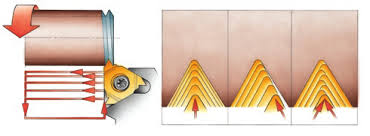

Thread Infeed Angle (also called Tool Nose Angle)
Back in the days of manual lathes, the machinist used to set the compound slide at an angle to the thread that's called the thread infeed angle. Being able to set that angle is important to ensuring a constant amount of material is removed and that the cutting spreads the wear to both sides of the insert or cutter.
Illustration by Sandvik shows three infeed strategies...
The illustration above, courtesy of Sandvik, shows thread infeed strategies:
- Radial Infeed: Go straight in with a 0 degree angle. Note that the force increases steadily into the cut as more area is being cutter the deeper we go.
- Modified Flank Infeed: Go in at an angle, which helps spread the wear and keep the force constant.
- Incremental Infeed: Alternate side-to-side while feeding at an angle.
Radial Infeed is quick and dirty, but it produces a stiff V-shaped chip which may have difficulty forming. The insert tip can also reach very high temperatures. This method is suitable for fine pitches, but for coarse pitch threads it often results in too much vibration (chatter) and poor chip control.
The Modified Flank Infeed is the one most commonly programmed in CNC machines. By choosing the right angle, we can avoid having the insert rub. Chips are formed much more easily. The chips are thicker than for a Radial Infeed, but they are much better behaved. As a result, fewer passes are often required and less heat is generated.
When specifying the thread angle, most people use an A58 for a 60 degree thread tool. This will cause the tool to move in at a 29 degree ( 58 / 2 ) angle on each pass thus cutting mostly on one side and just a little on the other side. if you program an A60 the tool will feed in at a 30 degree angle just cutting on one side.
If you've got a really large thread to cut, the Incremental Infeed method is probably best. Unfortunately, Incremental Infeed is not available on most G76 threading cycles.

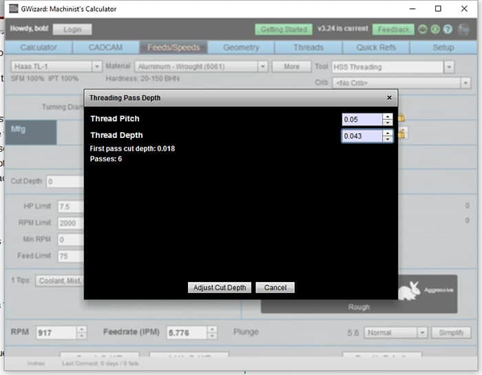

First Cut Depth
This value specifies the depth of the first pass. This should be the deepest cut you make since each subsequent cut will be harder on cutter and machine if you make every subsequent pass as deeply as the first one. The reason is the triangular shape of the thread cutter. As you push the triangle deeper into the cut, more and more area is being cut.
How much material should you try to remove on that first cut?
You can consult the cutter manufacturer, go on your experience, or you could use G-Wizard Calculator's handy Cut Depth Calculator:
GW Calculator suggest a depth of 0.018" for the first pass on a 1/4-20 thread...
GW Calculator suggest a depth of 0.018" for the first pass on a 1/4-20 thread, and it even estimates it will take 6 passes to cut the thread. We'll talk about the passes in a minute, but suffice to say that unless you actually simulate ALL the parameters of the G76 threading cycle, you can only estimate the number of passes that will be needed.
