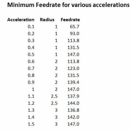

Before we get into looking at the effects of acceleration on cycle times, it would be good to know what the acceleration limits of your CNC milling machine are.  This information may be quoted in your manuals or available from the manufacturer, but often it's hard to come by.  Fortunately, determining your machine's maximum acceleration is a pretty straightforward exercise.  Probably the easiest way to do it is using interpolated holes.  Given an interpolated hole of radius r, and an acceleration of a, the feedrate that achieves that acceleration is given by:
Feedrate = SQRT( a * r )
Note that the three values must be in compatible units.  So, for a feedrate of IPM (inches per minute), you want an acceleration expressed as IPM squared, and a radius in inches.  I prefer to keep up with acceleration in g's, so to convert 1 G of acceleration to inches per minute squared, multiply by 43,200.  It's easy to use a spreadsheet to prepare a table of the values:
A table comparing minimum feedrates for various accelerations.
Feedrate versus Acceleration...
What you want to do is interpolate holes using until you find the highest acceleration where your machine can maintain the feedrate and still interpolate an accurate hole.  You can use G-Wizard Editor's Conversational CNC Wizards to generate the G-code for those holes, or any other means you like.  Use a soft material so that the feedrate isn't going to be a problem for your cutter.  It won't change the acceleration and it'll be much easier on the cutter.  MDF or any kind of plastic is cheap and cheerful for the exercise.  I'd start with the middle value and go up or down accordingly.

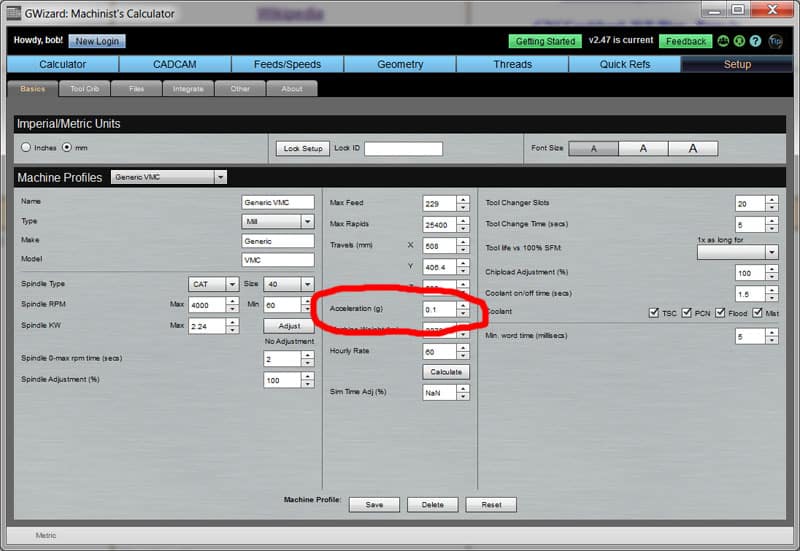

The first thing is to make sure you've set the acceleration for your machine on the Machine Profile:
A screenshot of a computer screen displaying a GWizard: Machinist's Calculator interface with a table and dropdown menus.
Enter your machine's acceleration in the Machine Profile...

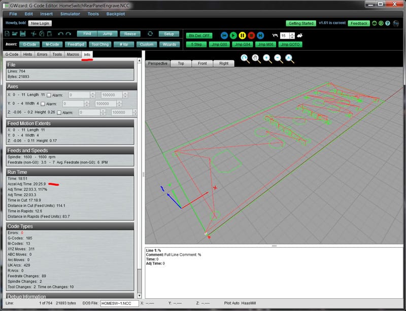

Now load up a G-code program and you're ready to play.  We'll use our usual demo, HomeSwitchRearPanelEngrave.nc for this article.  After loading your file, click the Info tab to see the effect of acceleration:
Computer screen displaying 3D modeling software with tools and features for designing and simulating machining processes.
Click the Info tab to see the Acceleration Adjusted Time for the G-code program...
In this case, instead of taking 18 minutes and 51 seconds, GWE predicts 20 minutes and 25.9 seconds.  That's a fairly significant difference.

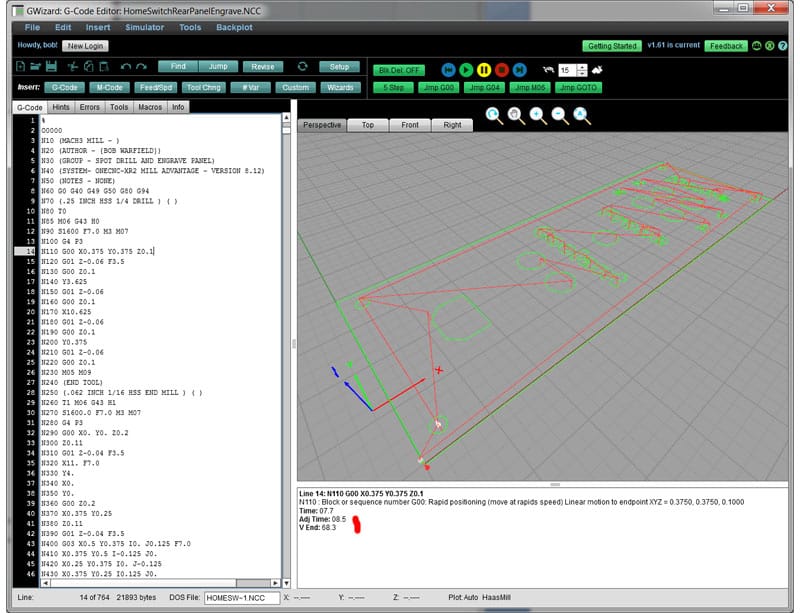

You can also see where the time is being lost on a block-by-block basis.  For example, here is the Hint associated with the first motion command in the program:
Computer screen displaying software used for machining.
Note the "Adj Time", which is the acceleration adjusted time to get to this point in the program, and the "V End", which is the speed the axis reached by the end of the block...
Two new pieces of information are available in the Hint for the block:
The V End value is particularly interesting.  The G-code was "G00 X0.375 Y0.375 Z0.1", which commands the axis to move to the XYZ coordinates at maximum rapids speeds.  In this case, the machine profile is configured to indicate that the machine's rapids are 400 inches per minute.  Yet, V End was 68.3 inches per minute.  The distance travelled did not allow enough time for the machine to reach full rapids before it got to the destination.  Hence it took longer than the more simple minded calculation of just assuming it went full speed from the beginning of the move (implying infinite acceleration).  You can use this information to track through programs and understand where the real limits based on acceleration are.
