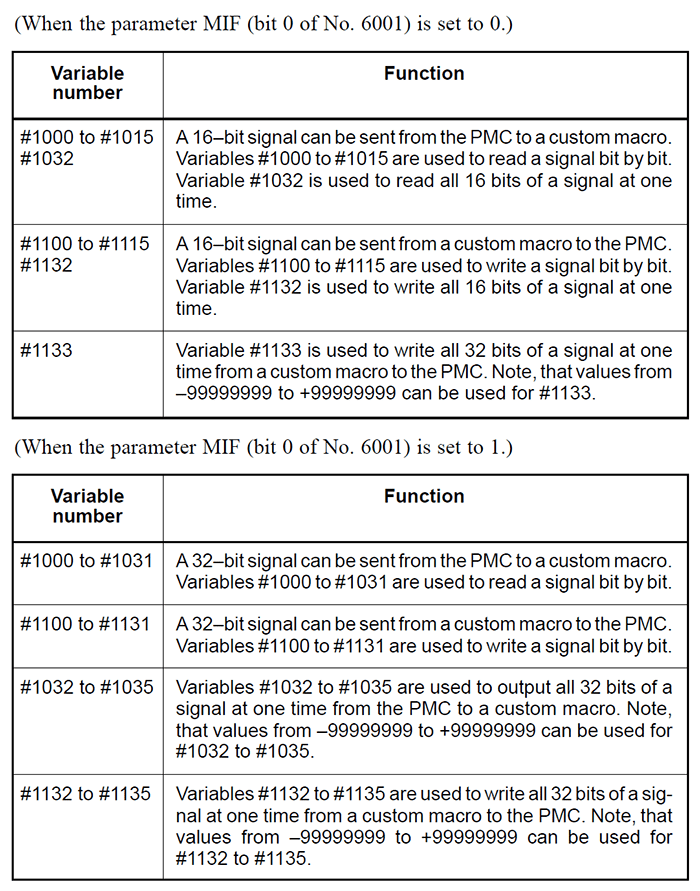

Interface Signals (#1000 – #1135)
fanuc macro system variables interface signals

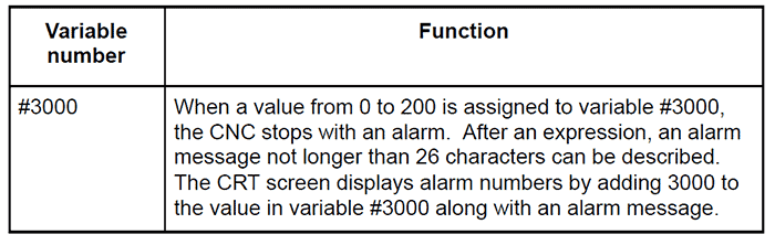

Macro Alarms (#3000 and #3006)
This is a very cool feature.  It lets you assign up to 201 custom alarms to notify the operator of various conditions.  Just because it’s called an “Alarm” doesn’t mean it has to signal a problem.  Think of them as messages your g-code program can send to the operator.
fanuc macro system variable macro alarm
For example you could have this line in your g-code program:
#3000 = 1 (Tool Not Found) ;
When that line is executed, the control will display an alarm saying “Tool Not Found”.  So, the actual message, which can be up to 26 characters, is contained in the comment following the assignment to #3000.
#3006 works the same way but it also stops the program.

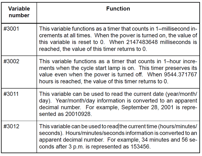

Time Functions (#3001, #3002, #3011, and #3012)
Being able to access timers or read the current date and time are very useful when g-code programming.  For example, maybe you want to compare how long a program takes to run versus historical averages.  You can time the program’s run time by accessing a timer and store that in a global variable for comparison.
If it gets off the historical averages by too much, perhaps you want to use the Alarm options to tell the operator to summon their supervisor to come see what the problem is.
fanuc macro system variables time and timer variables

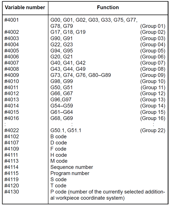

Modal Information (#4001 – #4130)
G-code is very modal, so being able to access what modes are currently in effect can be very important when g-coding.  As a matter of fact, we have a whole chapter on just that topic.  We’ll present the reference info here too:

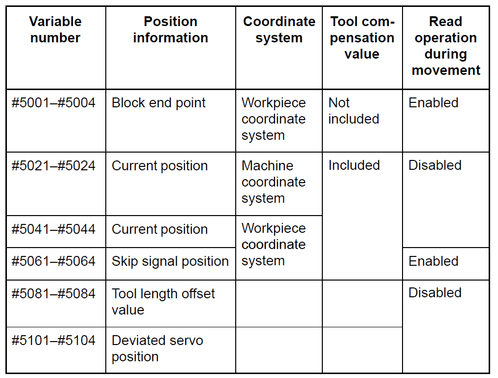

Current Position (#5001 – 5104)
Always handy to be able to access the current position.  These variables can be read, but no written:
fanuc macro system variables current position
Some things to note:
  • The first digit (1 to 4) tells you the axis.  X=1, Y=2, Z=3, A=4.
  • The tool length offset value currently in use is held in #5081 to #5084.
  • The tool position where the skip signal is turned on via G31 is held in #5061 to #5068.  When skip is not turned on, those variables hold the end point of the specified block.
  • When variables are marked “disabled” during movement, it’s because they can’t be read due to lookahead.

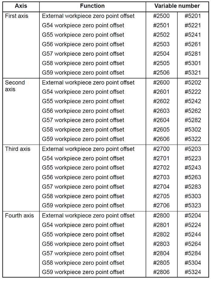

Workpiece Coordinate System (#5201 – #7944)
fanuc macro system variables workpiece offsets
The following variables can also be used:

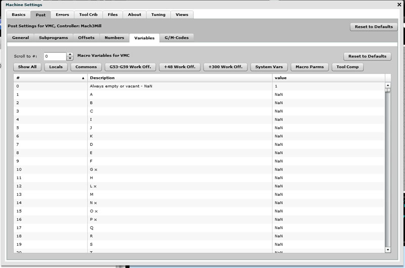

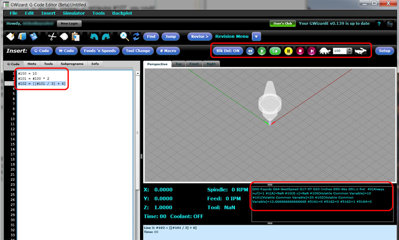

Macro Variables and Expressions in G-Wizard Editor
Our G-Wizard CNC Simulator and Editor understands macro variables and expressions, so you can use it to experiment with them a bit. Just bring it up and type in the expressions you want to see. Use the Simulator / Debugger to step through and see the results.
For example:

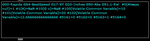

Debugging Macro Variables and Expressions with G-Wizard Editor…
Just type your expressions on the left. In this case, we have a pretty simple set:
#100 = 10
#101 = #100 * 2
#102 = [[#101 / 3] + 6]
Now, put the debugger in Single Block by selecting the button just left of the Tortoise.
As you step through a block at a time, the variables values are show in the box right below the backplot:
Macro variable values are shown below the backplot…
This little window shows all the modal activity, for example, we’re in G00 – Rapids mode. The values of Macro Variables are also modes of sorts, so they’re shown too. You get to see values for the last n variables whose value changed, and they’re sorted by variable #. Note how it also gives you a little hint about what the variable does. For example, it says #100, #101, and #102 are “Volatile Common Variables”. “Volatile” means their values are not remembered when the controller is switched off, and as we saw from the table up near the top of this page, variables in this range are Common Variables. G-Wizard doesn’t have all the variable values, but is has an awful lot of them and it will try to use this information to help you understand what’s going on.
You can see the full list of what it understands by looking under Setup, Post, Variables:
This screen is useful for a number of purposes. You can immediately see the current value of any variable, for example (anyone see the bug in the screen above? GWE has made a mistake on one of the variables). You can change the value of any variable just by double clicking it too. And you can see the different groupings for the variables with the row of buttons right above the table. The groupings will help you narrow things down to a particular thing you’re looking for, such as a Work Offset variable.
