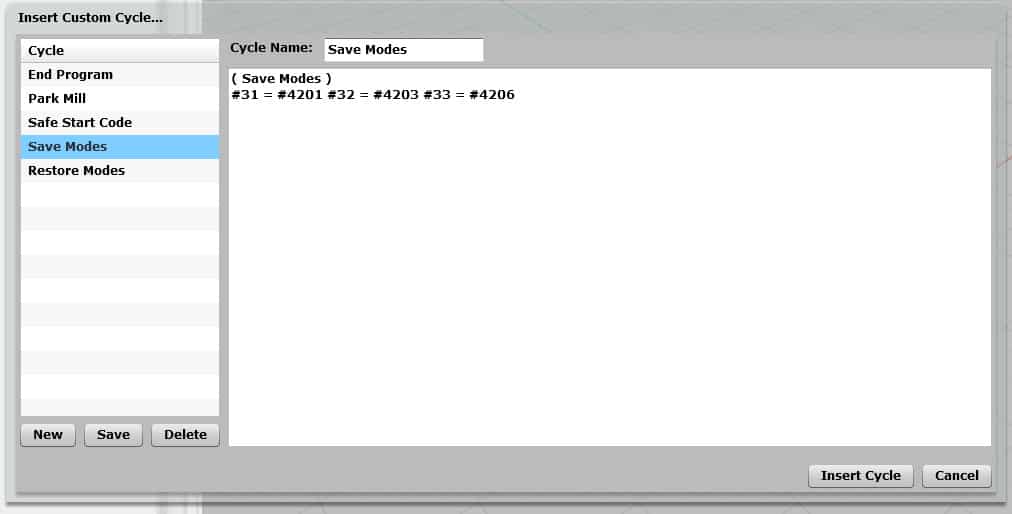

Mode Snippets
G-Wizard Editor also has a feature called Code Snippets that lets you save snippets of G-code for use in programming. Even better, there are two special snippets, "Save Modes" and "Restore Modes" aimed at using #4xxx variables in your programming. After reading this chapter, their use should be self-explanatory. Here's what they look like:
Computer screenshot with "Save Modes" menu option highlighted.
