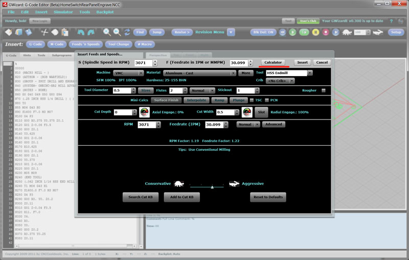

G-Wizard Editor is Integrated With the G-Wizard Feeds and Speeds Calculator
G-Wizard Editor includes Wizards to help insert all the different g-codes in the right formats. To add feeds and speeds type “Ctrl+P” (P for sPeeds and feeds). All our keyboard shortcuts have some kind of memory aid behind the choice of which keys to press, and they’re listed on the keyboard page. Once typed, you get a popup that lets you enter a value for feedrate and spindle rpm at the top. If you press the “Calculator” button (underlined in red below), you get to access the G-Wizard Feeds and Speeds Calculator:
Integrated feeds and speeds calculator
Integrating our feeds and speeds calculator with GWE…
Note that you have to be a registered G-Wizard Calculator user with a valid trial or subscription. Use the calculator as desired to calculate your feeds and speeds and then press the “Insert” button in the top row to add the “F” and “S” words with their addresses to your program.
