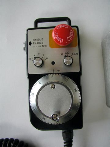

There are two approaches and each one involves a "mode". Your CNC machine has a variety of modes. For example, you probably already know about "Jog Mode", which is one way to cause the machine to move.
Jogging is where you're spinning a simulated electronic handwheel, or holding down a button or joystick to make the axis move. You generally select an axis, select a speed or multiplier (x1, x5, x100 or whatever), and then operate the control to move the axis. It's pretty easy. Here is a typical pendant with an electronic handwheel (called an "MPG" or "Manual Pulse Generator") for jogging:
A pendant for jogging a CNC. Select axis and speed then spin the wheel...
But, there is a better approach if you're actually trying to do some machining as opposed to touching off a setup.

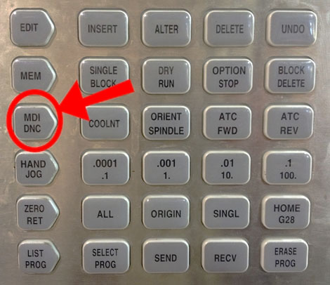

MDI Mode
MDI Mode is the trick you'll use to unlock even more productivity than Jog Mode. Yes, you can cut in Jog Mode and it's sort of like using handwheels or a power feed on your manual machine. But setting up to precisely cut to a certain point is much faster and easier with MDI Mode.
The Manual Data Input Mode (MDI) is one of the modes your CNC machine can operate in. The idea is to enter G-codes on a line which are executed immediately by the machine-you don't have to write an entire G-code program when a line or two will suffice. You just type in your line of G-code, press a button, and the machine executes it.
MDI offers a lot of power while requiring very little learning. With MDI, CNC can be quick and dirty just like manual machining. You can use MDI commands to machine your part, but even if you plan to run a part program, MDI is still super useful for setup operations.
MDI is accessed via the MDI key on your CNC machine's control panel:
Press the MDI key on your CNC control panel to go to MDI mode...
With MDI, you input short commands that tell the machine what to do. We'll get to our G-code cheat sheet for you shortly, but let me finish setting the stage first.

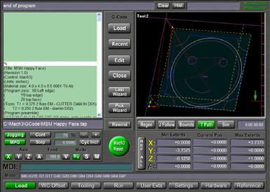

Digital Read Outs (DRO's)
Check out this Mach3 Standard Mill home screen:
Mach3 Standard Mill Screen Set...
You can see the XYZ DRO's on the lower right. Just to the left of them is the MDI type-in field. When not running a program, you can type G-code commands into the MDI field for immediate execution. Look up in your operator's manual how to go about accessing MDI for your controller.
Get familiar with where the DRO's are located on your CNC machine.

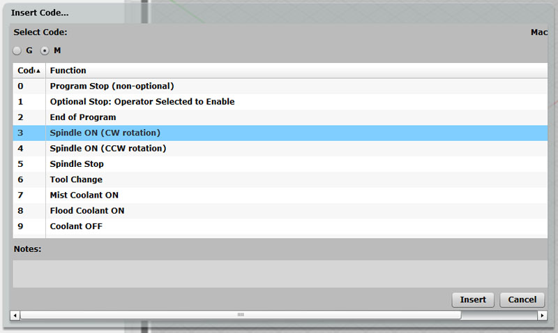

To actually start the spindle spinning you will need:
Clockwise Spindle: M03
As soon as you enter the “M03”, the spindle will start to rotate clockwise at its programmed speed.
Now you really are in business.
You can move the tool tip at feed speeds and you can turn on the spindle. Pretty easy so far, right?
You can stop the spindle with M05 if need be too.
And we’ve got most of it down. Just one thing, you probably don’t want to be cutting without some coolant, right?
Coolant: M07/M08/M09
Good idea, let’s don’t cut without coolant unless we really understand dry machining, and even then, we probably want an air blast.
There are definitions for what M07 and M08 are supposed to do, but I am not going to tell you what they are because they change from machine to machine. People can hook up the machines to do all sorts of things. For example, M07 could turn on an air blast or mist and M08 could turn on full flood coolant. Suffice to say M07 and M08 turn on two different kinds of coolant. Give each one a try to see what it does. M09 turns off the coolant, which is another good one to know.

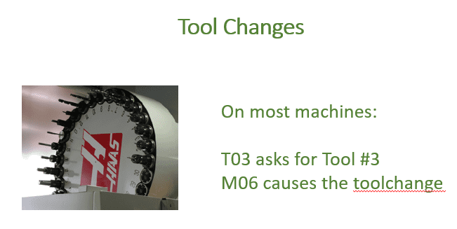

Tool Changing: T+M06
You could certainly manually insert a tool in the spindle taper. That’s not hard and you need to know how to do that. But if your machine has a tool changer, there’s a bunch of them sitting there and probably several would be convenient to access.
With just two more G-codes, you’ll know how.
Tool Changing is a two step process on a mill (and on some lathes, but most lathes don’t use the M06).
First, you select the tool with a T-Word followed by the tool number. Then you perform the tool change with M06. You can put them on two lines or write them together:
T12 M06
Select tool in slot #12 and swap it into the spindle.

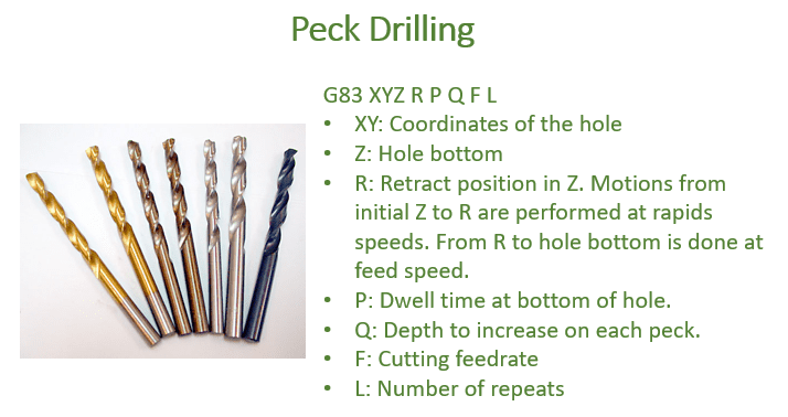

One more for extra credit: Peck Drilling
With those 9 G-codes, you can do a lot. You can run circles around your manual machinist friend, for example. And it wasn't hard to learn or understand either, right?
Well, in for a penny, in for a pound!
Let me give you one more, just because it is often convenient to drill holes using MDI G-code, and when you drill a hole deeper than one diameter, you really ought to peck drill.
G- Code includes what are called “Canned Cycles.” Canned cycles do all sorts of miraculous things in one command instead of requiring you to write a bunch of G-code. Imagine how painful peck drilling would be if you were programming each in and out cycle all the way down the hole with G01. You could do it, but it wouldn’t be much fun.
Canned cycles are available for all sorts of functions, but right now let’s learn how to do a simple G83 deep hole peck drilling cycle. I picked that one because it is fairly universal. There are faster cycles for special cases and slower cycles for other special cases, but this one will work for a lot of holes.
A typical G83 looks like this:
G83 XYZ R P Q F L
XY: Coordinates of the hole
Z: Hole bottom
R: Retract position in Z. Motions from initial Z to R are performed at rapids speeds. From R to hole bottom is done at feed speed.
P: Dwell time at bottom of hole.
Q: Depth to increase on each peck.
F: Cutting feedrate
L: Number of repeats
I’ve left out the addresses associated with X, Y, Z, R, P, Q, F, and L. Once the drill reaches the bottom of hole and has finished dwelling, retraction is at rapids speeds.
Now here is a real example:
G01 X0 Y0 Z0.5
G83 X0Y0Z-1.0 R0.1 P0.1 Q0.1 F2
We’ll ignore L for the time being. Repeats are probably not something you will use much for MDI. I stuck the G01 in so we would have a frame of reference.
So, the tool tip moves to X0Y0 and is 1/2″ above 0, which I usually program to be 1/2″ above my workpiece. We’re going to peck every 0.1″ on the way down. What that means is the drill will retract every 0.1″ of additional depth drilled. And, we’re going to dwell a tenth of a second at the bottom of the hole. This just cleans up the bottom and makes sure there’s no chips left down there.
Important: Once you complete a drill cycle, every move will start a new drill cycle at the new location. Cancel the drill cycle by running “G80”.
That’s it!
