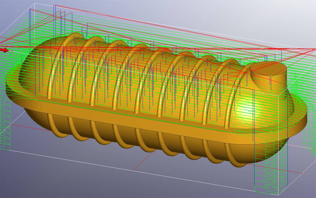

Program Using CAM Software▶
Deliverable: G-code Part Program Posted from CAM Software
Using MeshCAM to create a G-code Part Program...
Drilldown on the link to see how to go about Programming Using CAM Software.

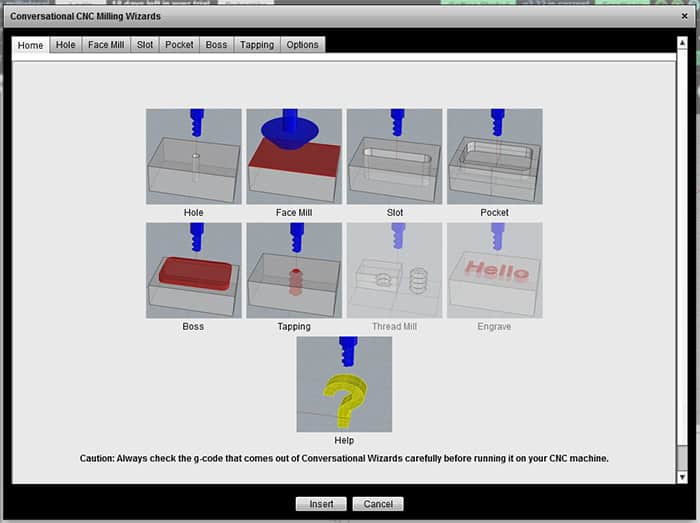

Program Using Conversational CNC▶
Deliverable: G-code Part Program Generated by Conversational CNC Software
Conversational CNC Menu for Milling Operations...
Drilldown on the link to see how to go about Programming Using Conversational CNC.

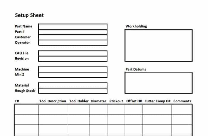

3
Finish Up the Setup Sheet▶
Deliverable: Finished Setup Sheet
A simple Setup Sheet...
In this final step, we'll verify our setup sheet matches the part program:
- Are the operations the same and in the same order in both the part program and the setup sheet?
- Do we have a proper tool list that matches the part program in our setup sheet?
- Does the setup sheet capture information about Part Zero and any Work Offsets used in the part program?
- Do we have full information about the workholding in the Setup Sheet and does it match the assumptions of the part program?
- What does the Part Program expect from the operator? Are there optional stops, messages, #variables to initialize, or other things the operator must pay attention to? This should all be documented in the Setup Sheet for the operator to refer to.
Some CAM software has the ability to generate a setup sheet as part of the process of posting G-code. This can be very handy to take advantage of, and we'll add any automatically generated setup sheet information to our Excel spreadsheet.
