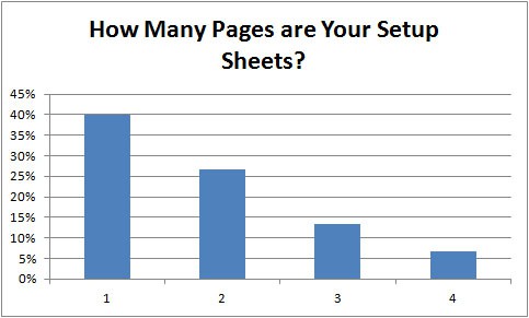

How Long are Your Setup Sheets?
Most, but not all, Setup Sheets are short…
Most, but not all, Setup Sheets are short. Given all the information some incorporate, I suspect there is a trade off here. At one end of the spectrum is the desire for something short and concise. Hence the popularity of the one pager. But it’s hard to see how a single page can really effectively document everything required to set up a job on a machine. Is that information simply tribal knowledge? Is it being figured out new every time someone new is trained to setup for the job? Is it being taken care of somewhere else? And is the push for brevity reflective as much of a desire not to invest much time creating Setup Sheets as it is a reaction to how useful longer Setup Sheets may be?
I’m thinking it’s the latter. Unless you have some means to help automate Setup Sheet creation, you’re going to want to keep it short. The more you can automate (for example generating them from your CAM software), the more information you can afford to carry along in there interests of fully documenting the job. There’s some fundamental tension here and at least one participant in an online thread about Setup Sheets that I started over on the LinkedIn CNC Machining group opined as how Management didn’t understand how valuable they were and therefore were unwilling to invest time in making them better. He thought that was wrong and I have to say I agree with him.
