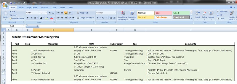

With a dimensioned drawing in hand, the next step is to organize the g-code programming. I like to put together an Excel spreadsheet to help keep my g-code work organized and make sure I’m covering all the bases. I use a format like this for the worksheet:
My G-Code Programming Worksheet…
Think of the worksheet as an outline of what the finished g-code program will need to do. I include a schedule like that for each of the hammer’s parts–Anvil (the interchangeable faces), Head (what the Anvil’s screw into), Neck (connects the head to the handle), and Handle.
The worksheet uses the following columns:
Part
Tells which part we’re working on.
Step
I number the machining steps.
Operation
Description of what’s to be done in that step.
Note
The details, such as dimensions or thread information about that operation.
Subprogram
Preliminary thinking about subprograms, if any, that will be used. I just assign them a number and use another page of the spreadsheet to keep up with them.
Tool
Identifies the tool that will be needed for the operation. I like to have no more than one tool in an operation and will the operation if multiple tools are needed. So, I have a “Drill” and then a “Tap” operation instead of a “Drill and Tap”. This is really a matter of your choice, but it’s easier for me to keep track since I’ll be doing manual tool changes on a Quick Change Toolpost for this project.
Comments
These are not comments about the step, they are the comment that will go into the actual g-code program to describe the step. Once you’re in Excel its easy to create these with string formulas.
You can download the G-Code Worksheet for the Hammer here if you want to follow along.

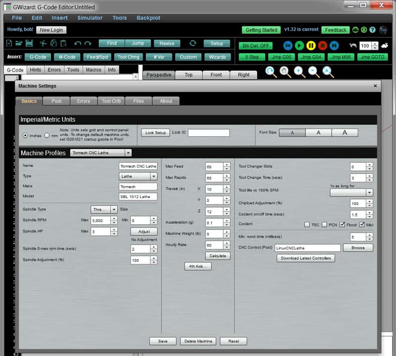

Once I’m happy that the worksheet has captured all the important information needed to give a good overview, I cut and paste those comments to create the initial program for each part. They won’t do anything yet because there is nothing but comments in them, but they provide the scaffolding that the real programming will be done against. Of course I like to use my G-Wizard G-Code Editor to do the actual programming, so I needed to set up a Machine Profile for the Tormach lathe. It’s very easy to do with specs from your machine’s documentation or their web site. I got my data from Tormach’s spec writeup on the lathe, here’s what that looks like:
G-Wizard Editor Machine Profile for my Tormach CNC Lathe…
And here’s what the initial g-code scaffold looks like for the Anvil:

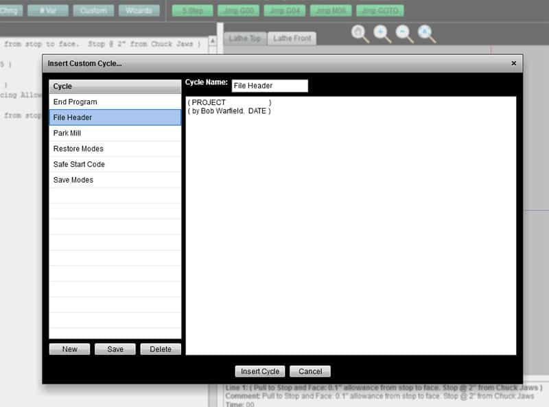

While we’re on the subject of code snippets, I should mention G-Wizard Editor’s Custom Cycles. I can’t tell what the part is in the Anvil code above, so I need to add a Header Block to my program that has some basic information. It so happens I’ve defined a Custom Code Snippet in GWE for that:
Custom G-Code Snippets are found under the “Custom” toolbar button…
Custom Snippets, or Custom Cycles if you prefer, are very easy to use. You use the popup to insert them into your code and to create, edit, or delete them from the library. Over time, if you do much hand programming, you’ll start to build up your own library of snippets. Okay, here’s Anvil’s g-code again with a header pasted in:

You’ll see I also inserted a “Safe Start Code” snippet right below the header. This just ensures some basic assumptions about start up conditions for the part.

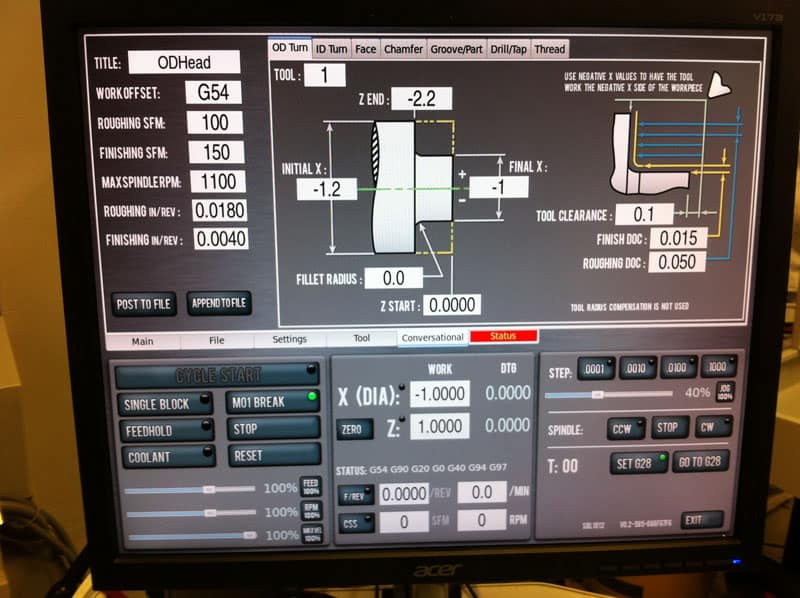

There are other ways to generate g-code besides using CAM or writing it by hand. You can also use a Conversational G-Code Wizard to generate code. The Tormach Lathe has a bunch of these handy gadgets built in for doing basic lathe operations. The next step in the program is to OD Turn to 1″ diameter for a length of 1″. Here’s what that looks like when set up in the Conversational Wizard:
Tormach’s OD Turning Converstional Wizard…
The Conversational Wizards are real easy to use. The OD Turn one pictured above is pretty obvious. Give it a few parameters:
– Title, feeds, speeds on left
– Tool
– Initial and Final X and Z
– Option Fillet
– Tool Clearance
– Rough and Finish Depth of Cut
The Wizard takes all that and cranks out some g-code:

By default, the code is set up to run as a stand-alone program since I just had it save to a file. We’ll need to edit it down a bit to get what we want, but the Wizard did an awful lot of our work for us. Incidentally, it only took me about 15 minutes to run through all the Wizard work I needed and collect the code snippets onto a USB key. The combination of the Wizards being easy to use and my Excel Worksheet having gathered up all the key information so it was at my fingertips made cranking out that g-code fast and easy.
