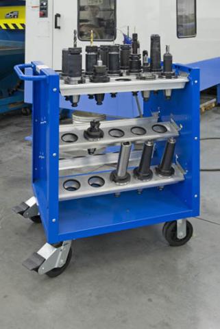

Load Tools
Deliverable: Tool changer on the machine has all the tools needed by the G-code program for the part.
CNC Rolling Tool Cart...
Note: If your CNC machine does have a tool changer, you'll still want to have all the tools in readiness so they can be popped into your spindle quickly as they are needed.
Our goal here is to get the tools into toolholders (or just available if your machine's spindle doesn't use interchangeable toolholders), and to load those toolholders into the machine's tool changer or make them handy near the machine for running the job and changing tools by hand.
If you have a CNC Setup Sheet for the Job, it will list which tools are needed as well as what their Tool numbers are in the G-code program.
Typically, we will organize the tools for a particular job on a tool cart or a tool tray as part of CNC Setup. Perhaps the tools are located in your shop's Tool Crib. You load the desired tools onto a cart, roll it over to your CNC Machine, and load the appropriate tools into the machine's tool changer.

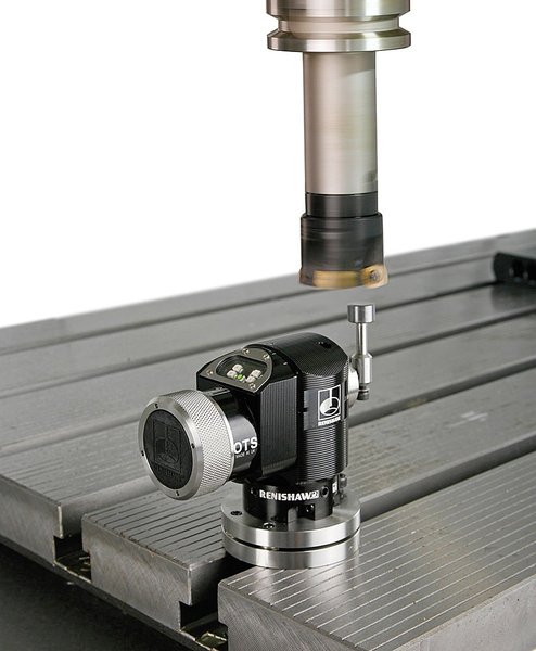

Set Tool Length Offsets
Deliverable: Tool Table on the CNC Machine has the proper length offsets for all the tools that will be used.
Setting tool lengths automatically with a Tool Touch Setter...
The machine needs to know how long the tip of the tool is from some reference, called the "Gage Point". It uses this information to adjust the spindle position relative to commanded positions for each different tool. This can be one of the more complex parts of CNC Setup, but it's not so bad once you've done it a few times.
It's very important that the Tool Length Offsets be correct for each tool and accurate to ensure the tool will cut correctly. In extreme cases, where the tool length offset is completely wrong, this can cause a collision that will damage the tool and likely the machine or workholding too.
Some machines will be equipped with a Tool Length Touch Setter. This is a special purpose probe that the machine uses to automatically measure Tool Lengths. In other cases, tool lengths are measured offline (meaning not on the machine) and entered into the Tool Table by the operator. This data entry could be done via:
- Manually punching it in on the front panel
- Loading it via a special G-code called G10
- Other methods
This is an area where it's important to follow procedures so that the Tool Table on the machine gets all the right offsets.

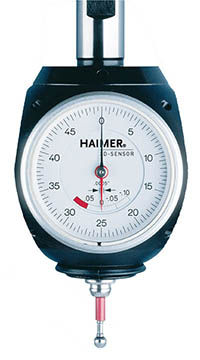

7
Set Part Zero and Work Offsets
Deliverable: The CNC Machine's 0, 0, 0 coordinate is properly aligned with the desired Part Zero. Any Work Offsets used by the program are properly set up on the machine.
Your CNC Machine has to be told where Part Zero is, physically. There are a variety of ways to accomplish this task. The goal of Work Offsets is to make it possible to have multiple part zeros. This is useful, for example, if you have multiple parts that each want their own part zero. Or perhaps if you want to install different fixtures that each have their own part zero on the fixture.
Ideally, the CNC Setup Sheet has a diagram or image showing you where part zero should be measured visually.
