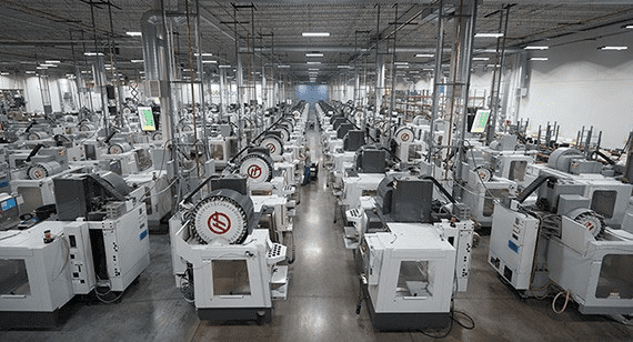

Space Planning and Clear Passage to the Machine Position
You can bet serious space planning went into this ProtoLabs facility!
You should pre-plan your space layout for the new machine, hopefully even before you purchase. Your machine distributor should be able to provide you with CAD Models that will help with space planning. Add a floor plan layout in your CAD Software for your shop that shows the locations of existing machines and you’re ready to do some space planning. Some even go so far as to 3D print a scale model of their shop with each machine.
You need to make sure your machine has a good spot on the shop floor and that there is room for everything that needs to go with the machine such as chip conveyors and bar feeders. As you look at situating the machine, make sure that doors and panels on the machine have room to open fully without hitting walls.
Make sure there is clear passage to move the machine into position as well. When you’re looking at clear passage, be sure to check for things like door clearance. Remember you need clearance for the machine as well as whatever rigging gear is being used to move the machine. Check for excessively tight turns and things like stairs.
As long as you have riggers on site to move the machine, you might also want to take care of adjusting the position of anything else heavy that you’ve been thinking about. You may achieve noticeable productivity gains in your shop’s work flow if you rearrange it.

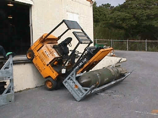

Riggers
Who is doing the rigging? Moving expensive heavy machinery calls for the expertise of a rigger. Often, the machine tool dealer will take care of this. If you’re hiring the riggers, you need to make sure everything is coordinated so the riggers are there as long as needed when the machine is due to arrive. Make sure they know exactly what’s expected of them, and answer all their questions so they’re well prepared.
Do you need to block off space in your parking lot for their truck? Make sure that’s taken care of ahead of time.

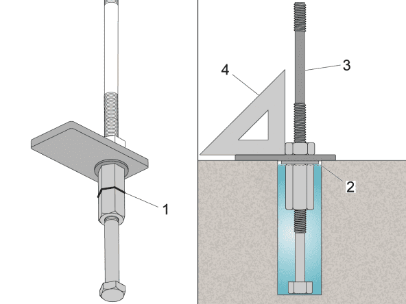

Foundation and Floor Prep
Anchors involve drilling a hole in your concrete floor that the anchor goes into. Epoxy (blue green color) holds the anchor in place.
CNC Machines can be quite heavy. Is your concrete floor thick enough to support your machine? Is it thick enough over the entire area the machine will occupy?
Make sure you have the proper anchors for your machine. You will need to drill and set the anchors in accordance with your machine’s requirements before it arrives unless your installers will be doing that for you.
According to Haas, CNC Machines are anchored for the following reasons:
- It increases the “apparent” mass of the machine.
- Improves dissipation of machine vibrations into the foundation.
- Improves overall stability and can reduce re-leveling requirements.
- Prevents axis acceleration from moving the machine.
- Keeps the machine aligned with accessory components (Bar Feeder, Pallet Pool / Changer).
Anchoring adds time and cost, but it’s worth the trouble and may even be required by your machine’s manufacturer.

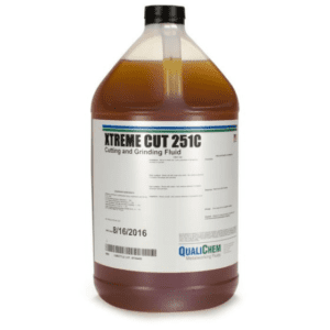

Coolant and Fluids
What kind of lubricating oil, way oil, hydraulic oil, and coolant will your machine need?
Find out the specific grades needed by your machine, purchase the fluids, and make sure they’ll all be on hand just before the machine arrives at your shop.
Coolant is typically mixed with water. Do you have the tools to measure proper coolant concentration? Do you have the correct water for your coolant? It may require distilled, deionized, or have other special water requirements.
Lastly, if your shop has a tramp oil solution, such as a skimmer, that you install on every machine, now is the time to order one for your latest machine.

Bob,
As a guy who spent a year as a USCG Explosives Loading Supervisor at Concord Naval Weapons Station, Concord, CA, your “Riggers” photo shows exactly the sort of thing you never want to see!
DJQ
Couldn’t pass up including that photo and emphasizing the need for professional riggers. Anyone can drive a forklift, but that’s not rigging!
