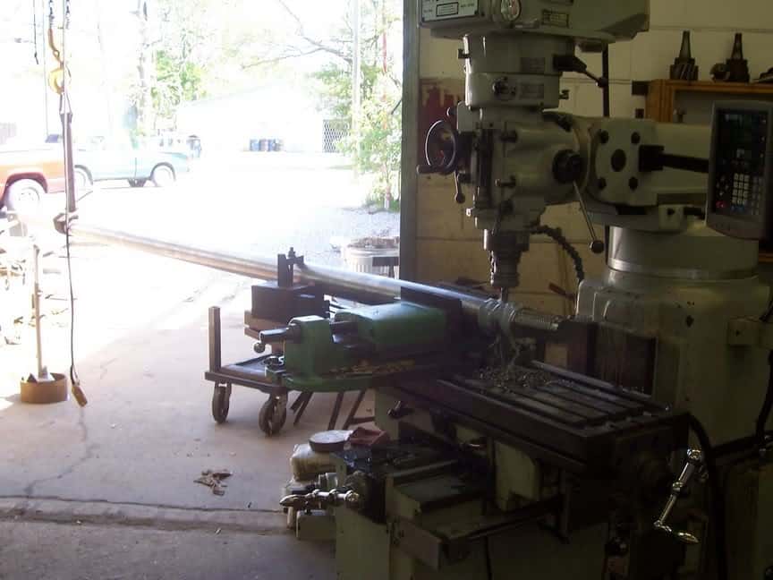

4. Support the Weight
Bigger parts are heavier parts, usually. Make sure the weight that’s not on the table is well supported with outrigger stands of some kind. You may need some kind of rollers so the machine can travel freely too. Lastly, make sure you have proper equipment to help load and unload heavy parts–no sense destroying your back on these big parts!
Supporting this shaft while milling a keyway at one end…
Our article on structural steel may be helpful when building supports.

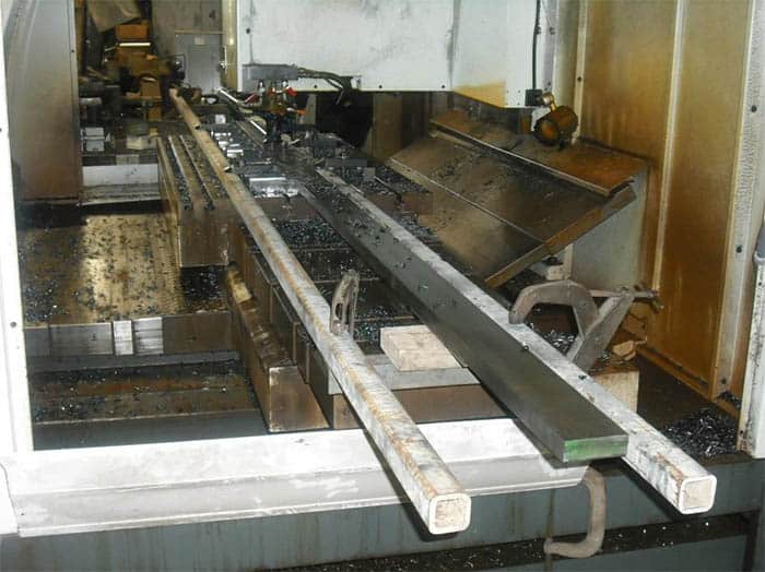

5. Slide Rectangular Parts
Machining rectangular parts that are too big for the machine typically involves some sort of sliding fixture. Check out this impromptu rig:
Slide rectangular parts…
This part is being slid along to allow holes to be drilled along its entire length. Note the enclosure has been partially disassembled and the square tubing is used as a framework to support the bar stock.
Tip: Use a couple of round pins installed on your table’s T-slots as stops for the work to slide against. dial them in parallel to the machine’s X-axis. You need to make sure the part has a true edge along its entire length that’s suitable to maintain squareness, otherwise, your first task will be to machine that edge.

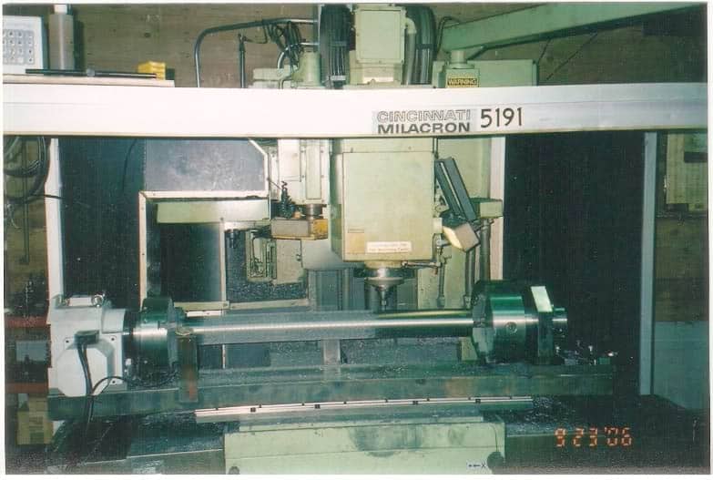

6. Sliding 4th Axis Fixture
This job involved drilling thousands of holes in large tubing that was too long for the machine’s travels. A sliding 4th axis fixture was created for the task:

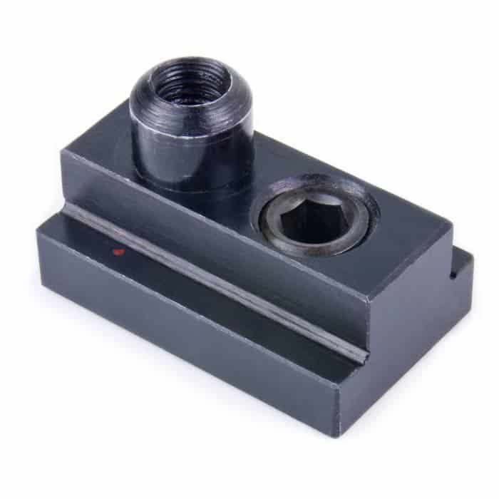

8. Slide And Spin to Extend Both Axes
Suppose you’ve got a part to machine that’s too big for both your X and Y axis travels? For this part, you may need to slide and spin the part. Here’s a sequence from a great Tormach article on the subject:
Tormach even makes locating pins that go right into the T-slots on their machine’s tables:

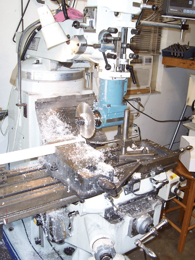

10. Right Angle Head Saves the Day
Sometimes, a right angle head can turn the part around to an orientation that saves the day. Take this set designed to make it easier to saw long stock:
Sometimes a right angle head saves the day…
You could imagine being able to machine features on the end of a long plate or other part using a right angle head like this too.

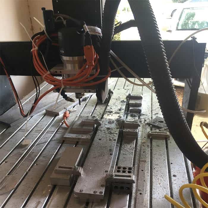

11. Use a CNC Router to Prep the Work
CNC Routers have big work envelopes, so they can often handle much larger parts than your mill is capable of. But, they have a variety of other issues that can make them unsuitable for doing the entire part.
Recently, I got a note from a long-time G-Wizard customer describing his solution to this problem. He has an inexpensive CNC Router in his home shop, and does CNC on a mill at work. They needed to work some parts that were too big for the mill at work. His first thought was to use the CNC Router at home, but there were porblems.
The part was going to have holes with counterbores for fasteners in various places. These holes had relatively loose tolerances that were well within the router’s capabilities. But, there were other features that needed tighter tolerances. Plus, the router spindle’s minimum rpm range was too high to drill the holes.
His solution was ingenious. He loaded the stock on his CNC Router and used it strictly to cut the counterbores by interpolating the holes with an endmill. The router made short work of this as its high spindle rpms were ideal. He had a mister cable tied to the gantry to keep things well lubricated so the aluminum wouldn’t weld to the cutter (something we suggest in our article on cutting aluminum with CNC Routers):
Note the mister nozzle pointed right at the end mill…
Now here’s where Gabriel got ingenious–the counterbores made ideal references for the mill. Using a probe, he was able to locate the part precisely and finish the part in stages, sliding it to fit the mill’s work envelope. He says that since he cut the counterbores all in one setup, and then probed the numerous counterbores, things came out within 0.0003″ on the part.
Very cool!
I have to say, I have wondered whether a decent 4′ x 8′ CNC Router wouldn’t come in super handy even for just rough cutting work pieces to size. This approach adds more credence to the idea it’d be useful to have one around.

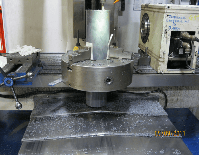

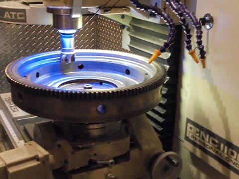

13. Part Too Big for Your Lathe? Try Your Mill!
A mill with a 4th axis is capable of some surprisingly lathe-like work. Consider this job, machining a flywheel for a big agricultural machine:
4th axis is sitting on the table with its axis vertical…
The 4th axis is sitting on the table with its axis vertical. You only need enough travels to address the actual travel of the cut, and a large enough envelope so the part can sit on the table and still spin.
Pretty clever!

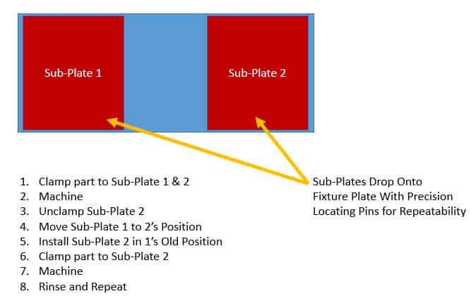

14. Make a Leapfrog Fixture
Modular fixturing is a great time saver. You put a fixture plate on your machine’s table, and it lets you drop sub-plates onto locations with a high degree of repeatability. You could use one in a “leapfrog” arrangement to keep a long part in alignment for multiple setups too:
The part stays clamped to one of the two fixtures at all times, and it is clamped to both for maximum rigidity during machining. When it’s time to slide the part, unclamp Sub-Plate 2, slide Sub-Plate 1 over and drop it into the dowel pin location where 2 had been. Install 2 where 1 had been and re-clamp. The repeatability of dropping the sub-plates onto the fixture plate underneath keeps everything in proper alignment as the part is slide along.

The idea of doing only counterbores and drill spots with the router was *not* my first plan.
What I tried first was… a masterpiece of idiocy, really. It’s an idea that definitely has a place, but the way I went about it was just not right. I took the router off, made up an adapter ring to fit the clamp for the router, and then stuck a DeWalt corded 1HP heavy duty drill in there.
Turns out that the things you can get away with at 15-20k RPMs create a lot more force when you do them at 1k RPMs, no matter how slow your feedrate is…
