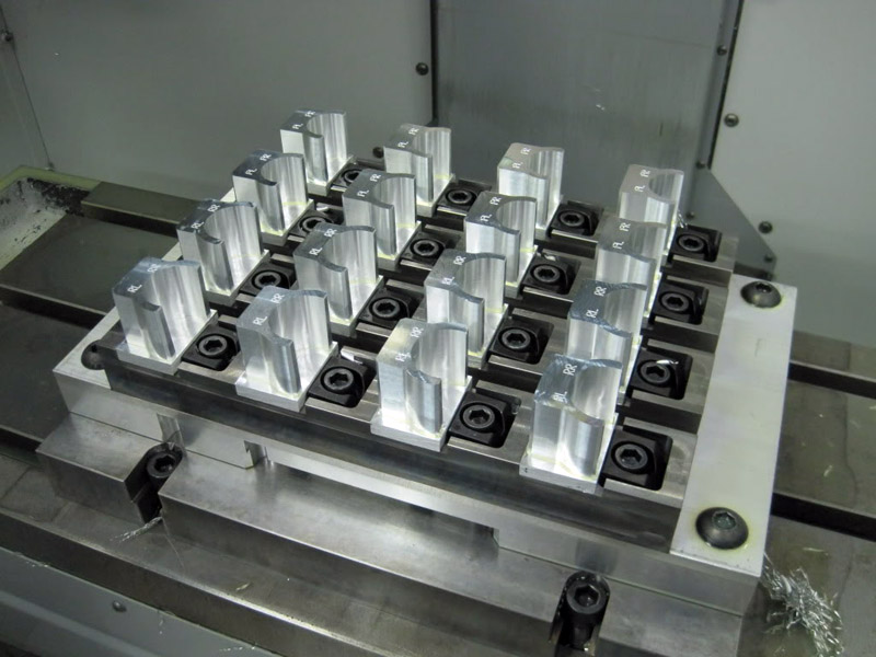

As useful as vises are, they have a sweet spot for part size. They have a difficult time with really large plate work, though as mentioned you can move the jaws to the outside positions for medium-sized plates. And, they can also be less than optimal for very small parts. Sure, you can fit multiple parts in a set of Soft Jaws, but the space between adjacent vises and the space required for the vise mechanism makes it hard to fully fill the table with as many small parts as you might otherwise be able to.
Metal pallet with 25 clear acrylic blocks in grid pattern.
It's hard to achieve this dense packing of smaller parts with a vise, but a plate fixture makes it easy. This one uses Mitee Bite Pit Bull clamps. The effect is not unlike tiny milling vises designed to fit each part just right.
When its time to machine large plates or a great many small parts, it's usually time to pull the vises off the table and use a workholding solution based on cnc clamps.
