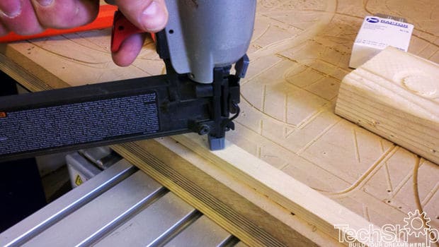

Polymer Nails into Spoilboard
This interesting idea is courtesy of James Irmiger of TechShop SOMA and Instructables. The idea is to use polymer (plastic) nails to secure the workpiece to the spoilboard:
Using Polymer Nails to secure the workpiece to the spoilboard…
According to James, the process is a little bit fussy and requires adjustment of air pressure and can be sensitive to overly hard wood. But, when once it is dialed in, it works great. Removing the workpiece just requires a little tap with a mallet to break the nails–they’re strong at resisting pullout but shear off easily. With a nail gun, this technique can be a lot faster than screwing into the spoilboard.

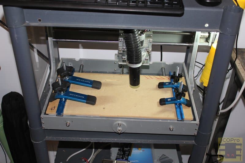

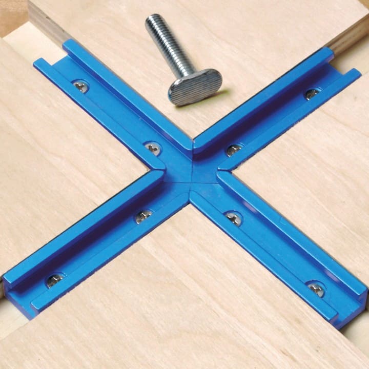

Clamps and T-Slots/T-Track
On CNC Routers, T-Slots are typically created using T-Track, which are metal T-Slots designed to be attached to your MDF spoilboards.
Rockler T-Track bolted down to top of MDF with Clamps…
Rockler T-Track Intersection Kit in a recessed slot with a typical bolt used with the track. Rockler has a wide variety of parts and kits for T-Tracking…
There are a wide variety of different T-Track systems and accessories for them available if you search the web. T-Tracks can be very versatile, but like bolting through to the spoilboard, you must take care the router doesn’t hit a bolt or T-Track in the middle of the job.
