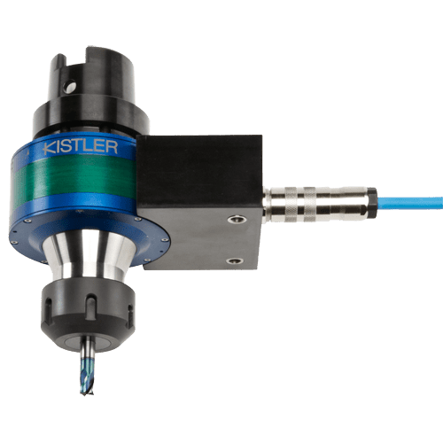

How to Measure Cutting Forces Directly
Measuring Cutting forces is done with a cutting force dynamometer.
