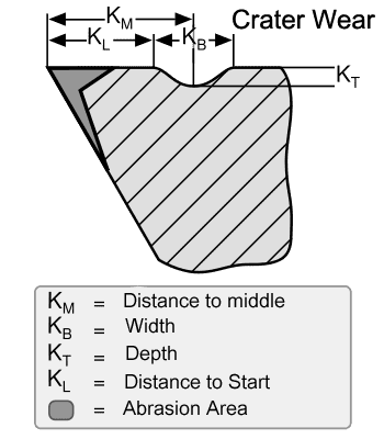

Crater Wear
Cratering, or crater wear, is a concave (yes, they look like craters) wear pattern on the rake face of the insert a short distance from the cutting edge.
It is caused by a chemical reaction between the workpiece material and the insert, and it happens as chips flow over the insert’s face at very high temperature. It develops as severe friction between the chip and rake face wears the insert.
This type of wear is most commonly observed where a continuous chip is formed. If left unchecked, this erosion can continue until a breakthrough occurs at the cutting edge.
The elimination of cratering is not always possible, but good results often can be obtained if crater growth is limited so that the maximum allowable flank wear is reached before crater breakthrough occurs.
Crater wear also occurs when the insert is too soft for the heat generated in the cut. Increasing the hardness of the insert will reduce or eliminate cratering. Reducing cutting speed and then the feed will also help reduce this type of wear.
