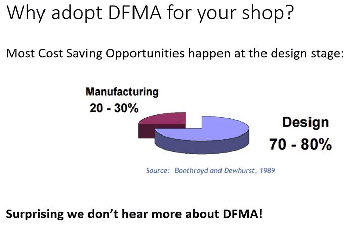

Design for Manufacturing (DFMA)
Most opportunities to reduce cost in machining occur at the design stage:
To learn more about Design for Manufacturing, check out our comprehensive guide.

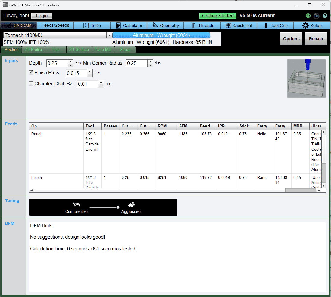

How to Optimize Machine Parameters
Optimizing Machine Parameters can either be done by trial and error, or by using a Feeds and Speeds Calculator that has an optimization function. Our own G-Wizard Calculator can do such optimization. It’s optimizing function is called CADCAM Wizards.
G-Wizard’s CADCAM Wizards are designed to find the optimal combination of Cut Depth, Cut Width, Spindle RPM, and Feedrate for a particular machining operation such as pocketing, profiling, homemaking, or facing:
The inputs for CADCAM Wizards are simple. Given those inputs it uses machine learning AI technology to optimize the parameters. In doing so, it considers over 60 variables.
It will make sure to keep tool deflection under control, avoid exceeding your CNC machine’s capabilities, and much more while maximizing Material Removal Rate and keeping Tool Life to reasonable levels.

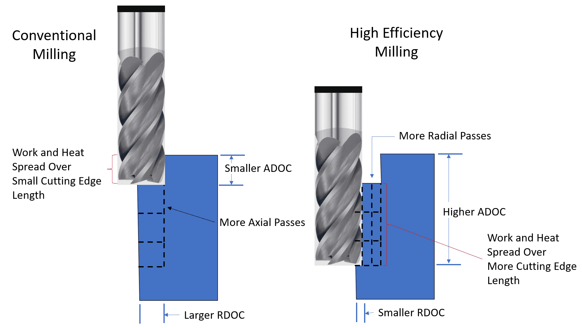

High Efficiency Milling Techniques
High Efficiency Milling (HEM) is a milling technique capable of reducing cycle times and extending tool life. HEM focuses on effectively using higher Axial Depth of Cuts and lower Radial Depth of Cuts to optimize the machining process. Chip thinning and controlling the angle of engagement assist in the efficiency as well. The use of HEM allows manufacturers to boost productivity and enhance the competitiveness of their production facilities.
The success of HEM depends on three essential components.
- Tool path: Intelligent tool paths generated by CAM software effectively manage cutting forces and maximize productivity.
- Tooling: Smaller end mills with a greater number of flutes (and a more robust, stronger core) running at higher speeds and feeds contribute to the efficiency of HEM processes.
- Technique: The proper technique in executing HEM processes is crucial for achieving optimal results.
G-Wizard’s CADCAM Wizards automatically optimize for the combination of higher MRR and higher Axial Depth of Cut thus delivering HIgh Efficiency Milling (HEM) right from the start.

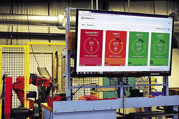

Real-time Monitoring and Data Analysis
Image courtesy of Cutting Tool Engineering…
Real-time monitoring and data analysis involve gathering, examining, and interpreting data in a timely manner to identify areas for improvement, optimize machining processes, and improve overall efficiency. This can help reduce costs, improve quality, and enhance productivity.
The use of these tools provides manufacturers with valuable insights into their CNC machining processes, enabling them to make data-driven decisions to refine their operations.
