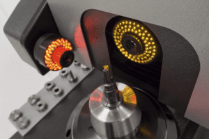

Premium Quality Control
Suppose you decide to purchase a particular make and model of endmill. They arrive and you discover that their diameters differ by 2 -3 thousandths of an inch. Now you’re going to have to measure each one and make sure there’s a proper offset loaded on the machine so it knows the diameter of each cutter.
Wouldn’t it be nice if the cutters were made to tight enough tolerances that for most jobs you didn’t have to check and adjust for each one’s specific dimensions?
That’s the value of Premium Quality Control.
Here’s another one. Suppose you’ve tested an endmill within an inch of its life and you know exactly where the maximum performance edge of the envelope is. You’re happily cranking out parts and making bank because of how fast those slick new cutters can go. You reorder another batch of them and BANG!
All of a sudden you’re dodging broken endmill shrapnell. What happened? More testing and you find the latest batch can only go 20% slower.
That variation costs you money, because you can’t go as fast as you thought and because you now have to either live with much more conservative feeds and speeds or take time to test each batch. Maybe even each endmill.
Again, that’s the value of Premium Quality Control. Consistency and predictability is worth a price tag.
