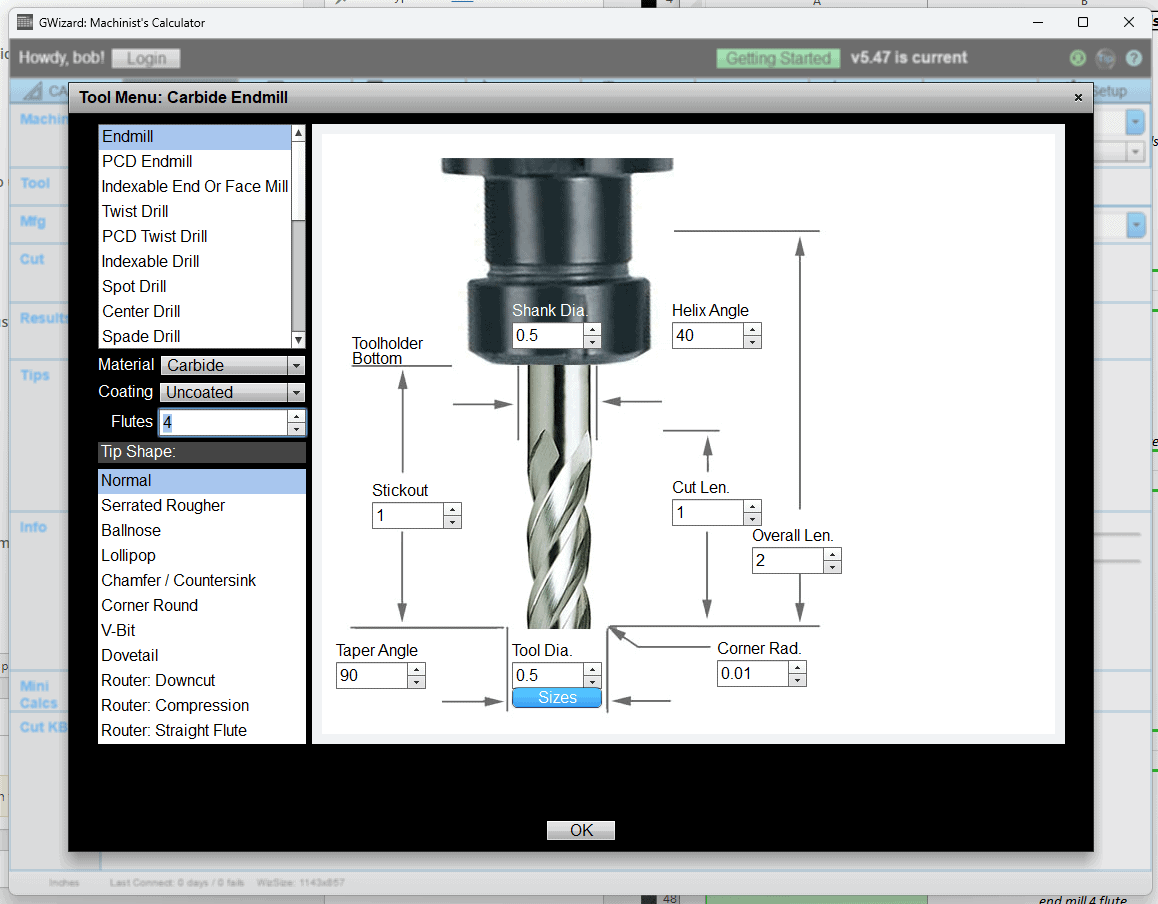

A Corner Radius End Mill can run with faster feeds and speeds than a square end mill.  You can use our G-Wizard Feeds and Speeds Calculator to figure out just exactly how much faster they can go.
Machining tool with detailed diagram of endmill components.
Specifying a corner radius end mill in G-Wizard is simply a matter of setting the Corner Rad. field to the corner radius.
