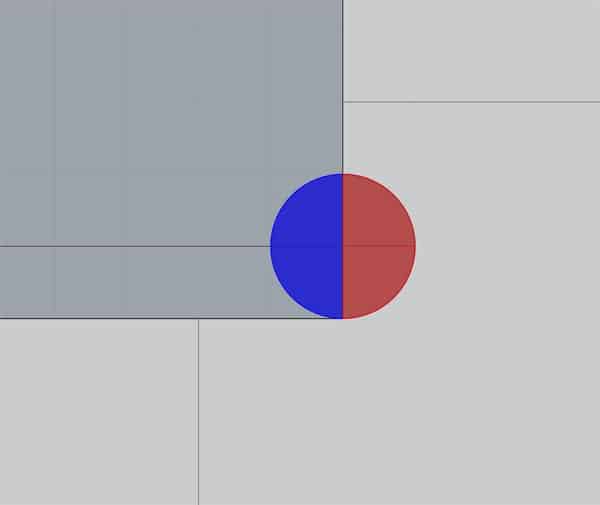

But there is more than one way to skin that cat. Consider the case of the humble corner again. Here’s a schematic view of a 1/2″ cutter plunging into a corner at the point where it reaches maximum pain:
Full corner engagement. The red is the part of the endmill actually cutting.
That poor cutter had been tooling along (pardon my pun) minding its own business at a 1/4″ (half diameter) width of cut, and suddenly, in the length of time it takes the cutter to move 1/4″ into the corner, the load has doubled. Boom! There’s that hammer blow.
We’ve all heard that little squeak of chatter that comes just in the corners on a job. That’s another reflection of what’s being shown here.
The red portion indicates the part of the cutter doing the cutting. It’ll roll off as the cutter turns up, but this is the point of maximum engagement. It’s easy to see the so-called Tool Engagement Angle is 180 degrees. Keep in mind that when you read an endmill manufacturer’s recommended feeds and speeds, they have to assume you will make some cuts like this from time to time. Perhaps even every time you pocket. If you do this sort of thing a lot, you’ve got the right feeds and speeds. But, if you’re using HSM Toolpaths that avoid this, or if you are using some other tricks I will mention in this article, you can go a lot faster. Or you can enjoy a lot better tool life if you prefer.

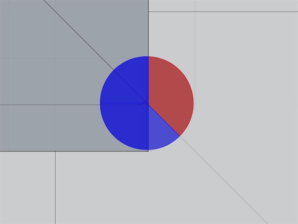

Using a Radius to Make a Corner Easier
In the previous example, our endmill had to turn a sharp 90 degree corner. Assuming we’re using a 1/2″ endmill, the actual part will have a 1/4″ radius instead of a sharp corner. Round tools leave a radius. In some sense, it’s a waste to make the tool take that sharp right angle turn when we’re going to have a big lazy radius on our part anyway. That leads to the question of, “What happens if we make the radius on the part a little bigger?”
Instead of a 1/4″ radius, let’s add 1/32″ to it. After all, we have 8 of those 32nds already, does it really matter if there are 9?
Here’s what that looks like for our cutter:
A little more corner radius makes the red portion of engagement quite a bit smaller…
Just that little bit of extra corner radius made life so much better for our poor cutter. The official number is that the extra 1/32″ of radius resulted in 27% less engagement for the cutter. Let’s put on our marketing hat and make that sound even better:
Compared to machining a 1/2 diameter width of cut, the full corner doubles the cutter force almost instantly while the additional 1/32″ of radius only increased it by about 45%.
Dang! That cutter is loafing now. I crank crank up the feeds and speeds for sure. Our G-Wizard Feeds and Speeds Calculator can tell you how much faster if you know the engagement angle. In this case, it went from 180 degrees to 142 degrees. For aluminum, a 1/2″ carbide 3 flute cutter, 1/2″ depth of cut, 1/4″ width of cut, G-Wizard gives us 7600 rpm and 64 IPM feed for the full corner. With the additional radius and new engagement angle, it gives us 10,000 rpm and 110 IPM. Wow, now we’re cooking!
