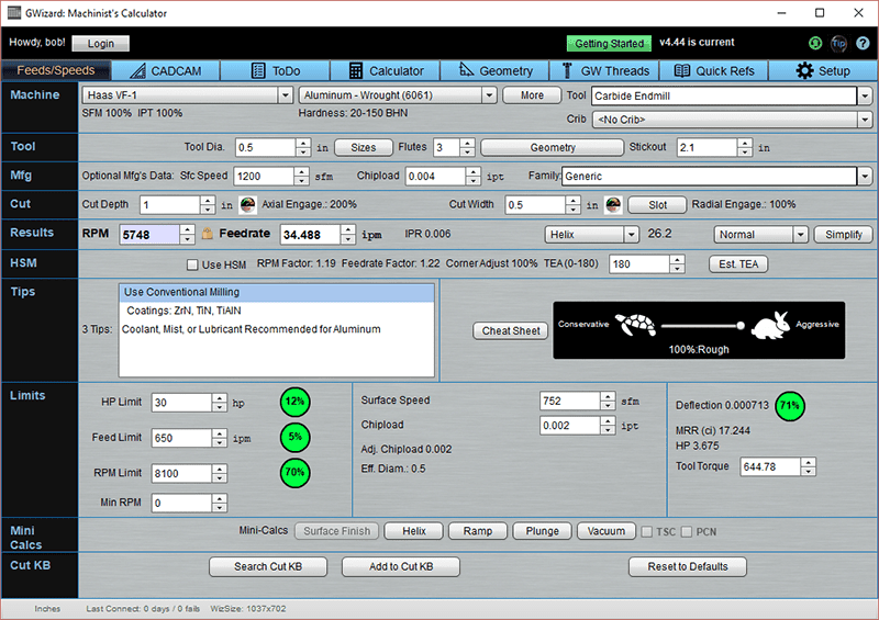

What if we could use a 1/2" endmill instead?
Machining software interface with tabs and data table.
We can use full slotting if we want to for a whopping 17.244 cubic inches per minute and the deflection is no sweat.  That's before we even optimize the cut to use an HSM toolpath like adaptive clearing or volumill to get even more.
Think of it, our MRR is about 19x faster.  Now we're talking!

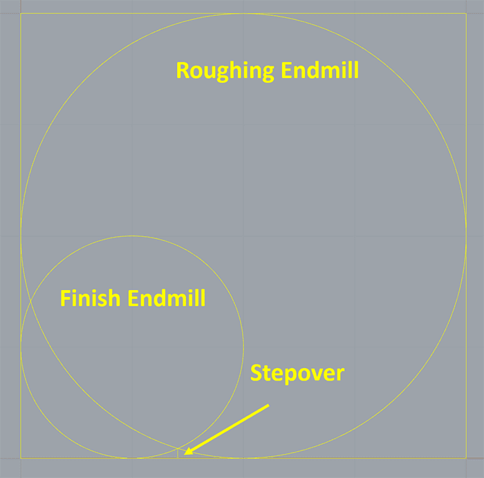

Here's a diagram to help you visualize the idea behind Corner Drilling:
Roughing endmill, finish endmill, stepover, and stepdown machining diagram.
You can see the small, finishing endmill sitting right in the corner of the pocket.  A larger (2x the diameter) roughing endmill is sitting as close as it can get to the corner.  And the short line segment marked "Stepover" is the amount of finishing allowance we want to leave for the small endmill.
The operation is going to work like this:
  1. Use a twist drill the diameter of the Finish Endmill (or the corner radius times 2) to drill a hole in the corner.  Don't put the edge of the hole right on the pocket wall because you'll never it it to line up exactly right and look right.  Rather, inset it diagonally away from the edge by and amount equal to the Stepover.  We do this before roughing out the pocket so we're not drilling a partial hole, which can lead to problems.  BTW, if the pocket is deeper than 5x the drill's diameter, you'll need to do some Peck Drilling.
  2. Now rough out the pocket with the larger roughing endmill.
  3. Finish using the smaller endmill that fits the corner and a finish allowance equal to the stepover.
For this ratio of cutter sizes (e.g. Rouger is 2x the Finisher), the Stepover is 0.0884 times the Finish Endmill's Diameter.  That'd be 0.0221" for our example, which is less than our Deflection-limited Cut Width of above, so we're in fine shape.
You'll need a toolpath that does "corner peeling" to finish the corners because the material to be removed there is more than the Stepover, but most HSM paths will do a fine job with that.  They often don't leave the best finish, so you might do 2 operations:
See how much faster that'll let you manage that nasty deep pocket?
