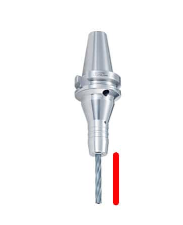

Stickout

His company was cutting wooden parts for some custom packaging work from 2 x 12 planks on a CNC Router. They’d started with 1/2″ endmills, but quickly found that the cutting forces were cracking their wooden parts, so they wanted to try a 1/4″ endmill. That’s when the tool life problems began in earnest. The parts were no longer cracking, but the endmills were breaking after just 3 runs. I plugged the parameters they were using into G-Wizard and quickly found the culprit–way too much tool deflection. About 0.0048″ at the feeds and speeds they were running. The trouble was, they were having to make 3 passes in the material at 1/2″ cut depth each to finish the parts and they didn’t want the job running any slower than it already was.

1. Try a larger diameter cutter. Sure, the 1/2″ cutter was splitting the wood, but how would a 3/8″ cutter do? This cutter is about 1.7x more rigid than the 1/4″ cutter and would have a real advantage.
2. If they had a tool changer, I suggested looking at taking the biggest cutter that wouldn’t split the part and trying 2 or 3 stickouts. Another problem with this job is that since they were going so deep in a 2×12, they needed the tool to have a lot of stickout which compromised its rigidity. Doing the first couple of passes with 1/2″ less stickout and a 3/8″ instead of 1/4″ tool diameter results in a whopping 15X improvement in rigidity. The cutter can stand to fly on those shallower cuts and should more than make up for the toolchange time.
