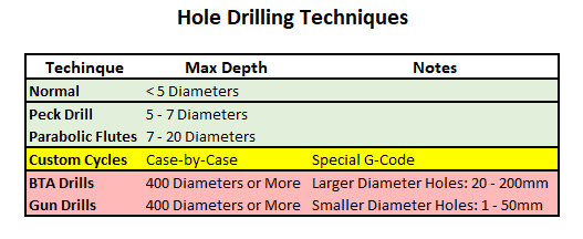

What About Even Deeper Holes?
We think of deep hole drilling in terms of drill diameter. A deep hole is any hole more than 5 diameters deep. The deeper you go, the harder it gets. A variety of techniques are needed, and peck drilling cycles are just one. Here's a handy chart to help you keep up with the various techniques:
To learn more about all the other techniques, check out our Deep Hole Drilling article.
