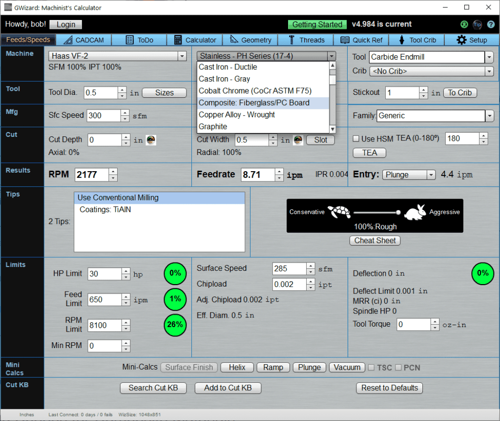

Whether you are using PCD tooling or not, you need Feeds and Speeds designed for your Composite Materials. Our G-Wizard Calculator can provide them.
To access them, select the Composite material family:
You can select PCD as a tooling material (assuming you have PCD tooling) as well.
Tool life is going to be shorter when machine these materials, it's a fact of life. But having proper Feeds and Speeds will help your tooling to last as long as possible.
