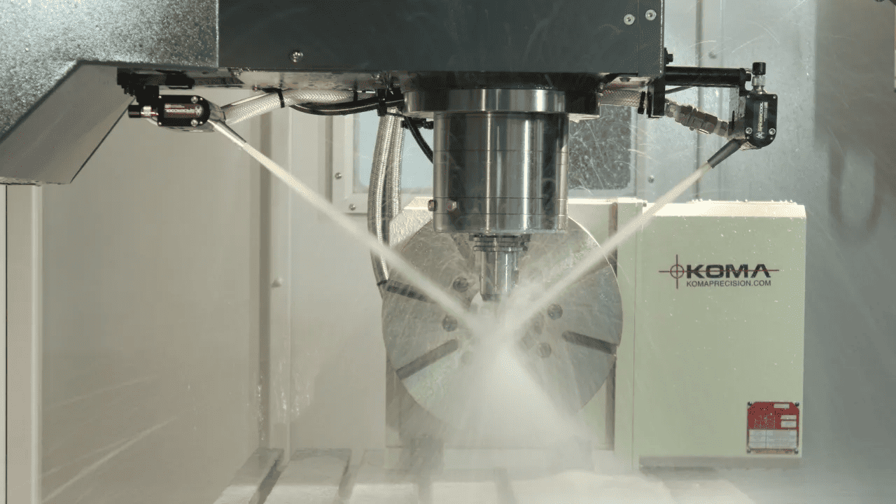

Chip Clearing: CNC Coolant #1 Priority
Chip clearing is by far the most important function. I cringe every time I see a cut where the chips pile up.
Sure, it's easier to photograph the action. But those piling chips are very hard on your cutter's life and can even lead to breakage.
If the cutter must recut the same chips over and over again, you’re much more likely to experience built-up edge (BUE). BUE is where chips weld onto the cutter. It's possible to use up all the chip clearance your cutter has available. The older chips have to compete with freshly cut chips, which can lead to cutter breakage.
At the very least, it means you can't cut as fast.
If your machine has no flood coolant, rig up an air blast or mist to get the chips out of there. Get paranoid about having too many chips around.
Most tooling manufacturers recommend you turn off the flood coolant when surface speed goes above a certain point[2](javascript:void(0))Application of coolants during tool-based machining – A review Khor Zheng Yang a, A. Pramanik a, A.K. Basak b, Y. Dong a, Chander Prakash c, S. Shankar d, Saurav Dixit e f, Kaushal Kumar g, Nikolai Ivanovich Vatin e. They say this will increase the life of your tooling. If it was all about heat, that shouldn’t be the case as more surface speed means more heat.

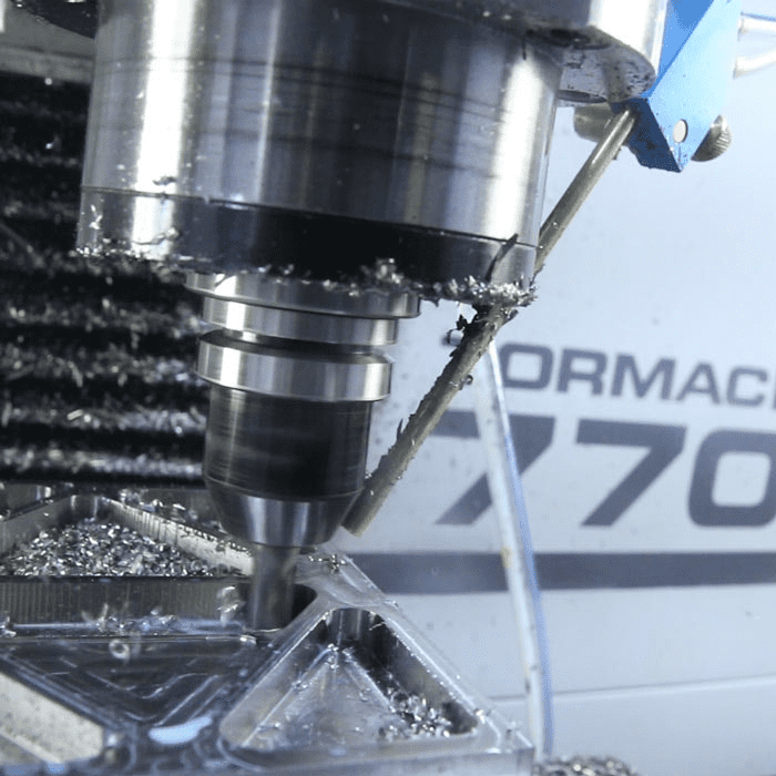

How to avoid flood coolant with mist
If you don’t have a full machine enclosure, flood coolant is messy and almost unusable. Fortunately, cooling is the least important thing about cnc coolant. We still must manage chip clearing and lubrication, but cooling is less important. So, we can dispense with flood coolant for many applications. A strong compressed air blast will handle chip clearing. Adding a lubricant to the air blast to make a mist takes care of lubrication.
Here's a Fogbuster Mist Cooler mounted on a small Tormach CNC Machine:

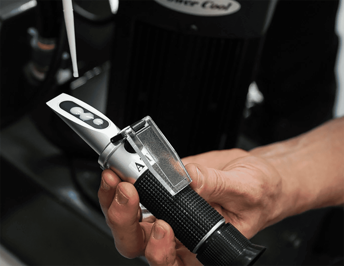

CNC Machine Coolant Concentration
When using coolants that incorporate water, it is important to understand the appropriate coolant concentration to achieve the best results. This concentration is measured with a refractometer[3](javascript:void(0))Fukuta, Mitsuhiro; Yanagisawa, Tadashi; Miyamura, Satoshi; Ogi, Yasuhiro (2004). "Concentration measurement of refrigerant/refrigeration oil mixture by refractive index". International Journal of Refrigeration. 27 (4): 346–352. doi:10.1016/j.ijrefrig.2003.12.007 and must be monitored regularly to offset the effects of evaporation.
Measuring coolant concentration with a refractometer...
If the coolant concentration is lower than the minimum requirements it can result in:
- Microbial Growth
- Faster tool wear on cutting tools
- Corrosion of parts and machinery
On the other hand, excessive coolant concentration can result in:
- Foaming
- Toxicity
- Concentrated Wastage
- Reduced heat conduction
- Poor lubrication
- Discoloration of machinery or machined parts
- Degradation of tools due to residue build-up

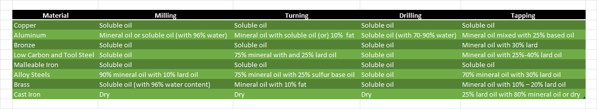

CNC Coolant Concentration vs Materials
Material
Milling
Turning
Drilling
Tapping
Copper
Soluble oil
Soluble oil
Soluble oil
Soluble oil
Aluminum
Mineral oil or soluble oil (with 96% water)
Mineral oil with soluble oil (or) 10% fat
Soluble oil (with 70-90% water)
Mineral oil mixed with 25% based oil
Bronze
Soluble oil
Soluble oil
Soluble oil
Mineral oil with 30% lard
Low Carbon and Tool Steel
Soluble oil
75% mineral with and 25% lard oil
Soluble oil
Mineral oil with 25%-40% lard oil
Malleable Iron
Soluble oil
Soluble oil
Soluble oil
Soluble oil
Alloy Steels
90% mineral oil with 10% lard oil
75% mineral oil with 25% sulfur base oil
Soluble oil
70% mineral oil with 30% lard oil
Brass
Soluble oil (with 96% water content)
Mineral oil with 10% fat
Soluble oil
Mineral oil with 10% – 20% lard oil
Cast Iron
Dry
Dry
Dry
25% lard oil with 80% mineral oil or dry

Where you aim the coolant matters, whether for chip clearance, cooling, or lubrication. But how many machinists take time to aim the coolant after each tool change? Different tools have different lengths. Different machining operations may also change the best aim of the coolant.
Adjusting the coolant nozzle is a productivity burden. Avoid it by using multiple nozzles preset to a range of heights. With three nozzles, you can cover a pretty decent range.
The problem with this approach is you now only have 1/3 of your coolant available at the ideal spot. With enough volume and pressure there is a wall of coolant. That's why the high pressure and volume option available for most machines is worthwhile.
Lastly, you can retrofit your machine with an automated nozzle that allows you to pinpoint your coolant by twisting a knob on the control panel. These programmable coolant nozzles can track your tool changes and change the aim automatically, something that will improve the efficiency of any milling process.
Spidercool programmable coolant nozzles...
What’s good aim worth? Spider Cool says its good for 5% better MRR, and they have a free trial to prove it. Might be worth checking into your coolant aim.
Our G-Wizard Feeds and Speeds Calculator made an allowance for a Programmable Coolant Nozzle in its Feeds and Speeds Calculations.
BTW, if you’re very conscientious about coolant and take time to make sure your nozzles are properly aimed, you could go ahead and tick the box for PCN and get the bonus. You’re doing the same thing the automation does.
One thing you’ll quickly discover about these bonuses is they can be a very cost effective way to improve your shop’s productivity. Investments in better coolant technology are often not that expensive relative to the benefits you get on nearly every job.

When is the right time to change a CNC machine coolant?
Most CNC machine makers recommend changing coolant every 6-12 months as a general rule of thumb. The exact time to change coolant will be based on the machined material, coolant type, amount of machining use, and operating condition of the CNC machine.
How do I kill bacteria in CNC Machining Coolant?
There are several ways to kill bacteria in CNC Machining Coolant. They range from anti-bacterial additives that can be put into the coolant to ozone treatments to preventing oil films from blocking oxygen exchange with the coolant.

What is the best coolant for CNC machines?
Never use water by itself, as it can lead to rust and corrosion. Instead, use one of the following types of coolant:
Soluble Oils
Soluble Oils are inexpensive and are the most common in machining operations. They're created by adding mineral oil to water in specific percentages. Emulsifiers are also added to keep the solution mixed. Other additives add additional useful properties such as corrosion resistance, bacteria prevention, and lubrication. Soluble Oils work best in light-cutting operations.
Synthetic Fluids
Synthetic Fluids combine water with additional chemical compounds but no mineral oil. Other additives can include lubricants, rust inhibitors, and corrosion inhibitors.
A primary benefit of Synthetic fluids is no foaming. Foaming is more common in mineral oil-based coolants.
Synthetic Fluids are more durable than other metalworking fluids.
Semi-Synthetic Fluids
Semi-Synthetic Fluids are a blend of mineral oil, corrosion inhibitors, and additives for clean operation in high-speed and high-pressure CNC machines.
Straight Oils
Straight Oils are not mixed with water and have a mineral or petroleum oil base. The include additives that are biodegradable and environmentally friendly.
Straight Oils provide the best lubrication but have the poorest cooling characteristics.
