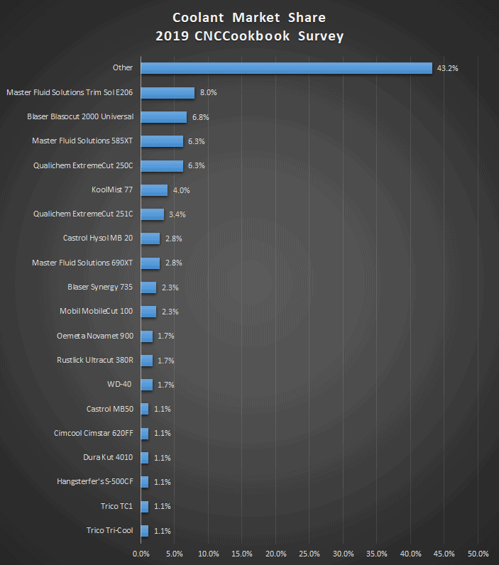

CNC Coolant Market Share
This Buyer's Guide will only consider coolants whose market share among respondents was over 1%.
Here are the relative market shares of those coolants:
Coolant Market Share 2019 Chart by CNCCookbook.com.

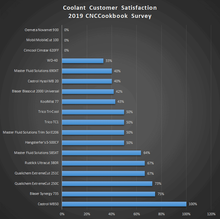

CNC Coolant Customer Satisfaction
We asked respondents to rate their coolant at 3 levels:
The market share scores below represent the average of the votes.  A 100% indicates that every respondent said, "It rocks!"
Bar graph illustrating customer satisfaction rates for various coolant products.

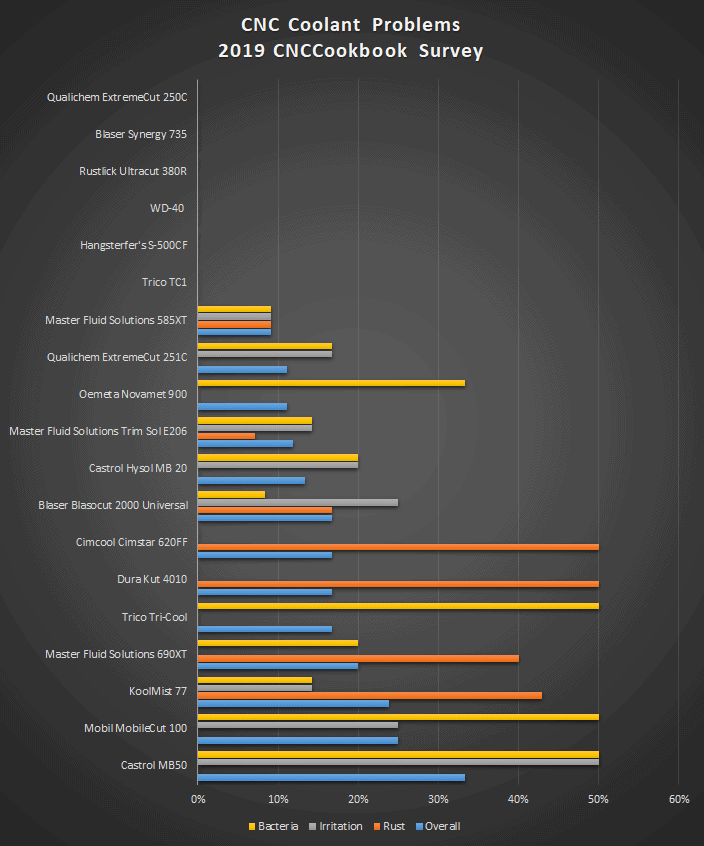

CNC Coolant Problems
We asked respondents to tell us whether they'd had coolant-related problems with Rust, Skin Irritation, or Bacteria/Odor problems.  This report reflects the percentage of folks using the coolant product that had each type of problem as well as the average of all the problems.
CNC Coolant Problems 2019 survey results bar chart with CNCCookbook survey data.
