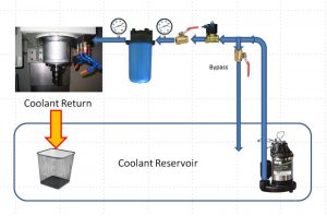

Here is a schematic of the overall system:
Coolant is grabbed by a 3/4 HP sump pump and goes to a tee between the bypass line and the electric solenoid valve. The solenoid lets you control cnc machine coolant via g-code. The bypass lets me regulate coolant pressure and flow by simply bypassing some back to the reservoir if there’s too much.
This makes the pump’s life a lot easier than just shutting down the flow from the pump and creating a lot of back pressure. We can regulate the amount of bypass using the two hand valves.

There is a cannister filter with a 20 micron element to capture fines and chips before they go back into the cnc machine coolant plumbing. Just use a whole house water filter from the local hardware store, they’re cheap:
John Grimsmo adapted a household water filter to clean up his coolant…
John Grimsmo filters his coolant. This is an excellent upgrade because it removes fine chips that are otherwise circulating in the coolant and can clog lines (especially nozzle tips) and even damage parts as John shows in the video. Adding a filter is super easy and ought to be one of the first coolant upgrades you try.
The two pressure gages make it easy to tell when the filter element should be changed. The difference in the pressure readings tells when the filter is not passing through as much cnc machine coolant as it should. I will move the solenoid valve downstream of the filter so it is also protected.

Once past the filter, the Coolant goes to a manifold on the spindle that has multiple line loc lines with nozzles and individual valves for each. That will let you create a wall of coolant to push chips aside.
Coolant return comes from the coolant tray and drops through a hole into a 5 gallon bucket that sits in the coolant reservoir below the hole. The bucket sits on a plastic foot stool so the chips inside will drain. Between the bucket and the foot stool is an EZ-Strainer disposable 400 micro filter to keep the worst of the chips from getting into the coolant tank. Cleaning out the chips is simplicity–just pick up the bucket and dump it
Put your reservoir on a furniture dolly so I can pull it out for easy maintenance.
