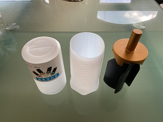

Here’s some photos of what they look like up close and personal:
Typical packaging…
Here’s what you get inside…

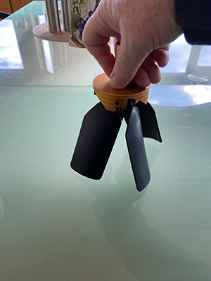

Fan blades are spring loaded…

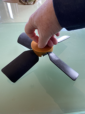

They start to open at 500 rpm…
Note that any chip fan is limited to a maximum operating speed in most cases.
