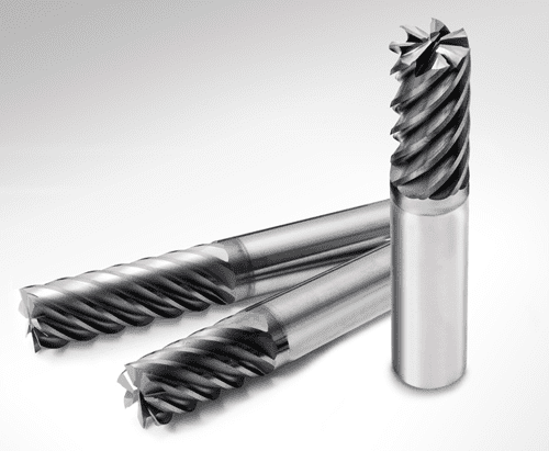

1. Use a Cutting Tool with More Flutes when Machining Titanium
titanium machining endmills
The properties of Titanium keep rpms and chiploads low.  A 10 flute endmill is too tight for the chiploads most materials can handle, but it can work fine with Titanium, especially given you need to reduce radial engagements.  Cranking up the number of flutes is the only way you can get cycle times into the realm of productivity.
The ability to keep more teeth engaged in the cut will also tend to reduce chatter.  Titanium’s lack of stiffness can make it more susceptible to chatter.

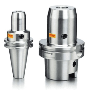

2. Prevent Tool Pullout
how to machine titanium with hydraulic chucks
Sandvik’s high precision hydraulic chucks can really grip a tool tightly and prevent pullout…
Huge cutting forces, shocks, and vibration are all common when machining titanium.  They’re also a perfect storm when it comes to pulling the tool shank right out of the holder.  Even a little slip radically increases cut depth which raises cutting forces which causes more slip.  It’s a vicious cycle and one you must avoid.
Use proper procedures with collets to make sure they hold as tight as they can.  Keep everything clean and torque the collets to their optimal spec.
Weldon shank holders are even more secure from pullout as are hydraulic mill chucks.

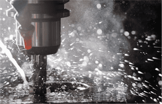

9. Use High Pressure Coolant
high pressure coolant for machining titanium
Remember, titanium conducts heat very poorly.  Your oven mits probably conduct heat better, LOL!
It’s hard to get the heat out of the workzone.  Left there, it will wind up destroying our cutting tools and thermal effects will make holding tolerances difficult.  Therefore, we want the best flood coolant setup we can get when machining titanium.
A high pressure coolant system really helps.  Depending on the application, through spindle may also be critical.
You may also find that increasing coolant concentration is helpful with titanium.  It needs the extra “juice” to promote lubrication and prevent chip welding.

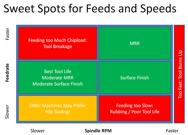

10. Use Proper Feeds and Speeds
I often refer to a “Sweet Spot” balance of feedrate and spindle rpm:
The Sweet Spot is not shown to scale because it varies from one material to the next.  Difficult materials have a very small sweet spot.  The range of values that work is small.  Accordingly, you want good feeds and speeds, preferably generated by a high quality feeds and speeds calculator like our G-Wizard.

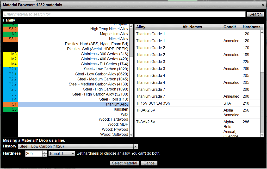

Titanium and Titanium Alloys
Like most metals, there are many Titanium alloys (nearly 40 ASTM grades as well as several additional alloys).
Grades 1 through 4 are basically commercially pure titanium graded for ultimate tensile strength.  Grade 5 (Ti6Al4V or Ti 6-4) is the most common Titanium alloy.  It has 6% aluminum and 4% vanadium added.

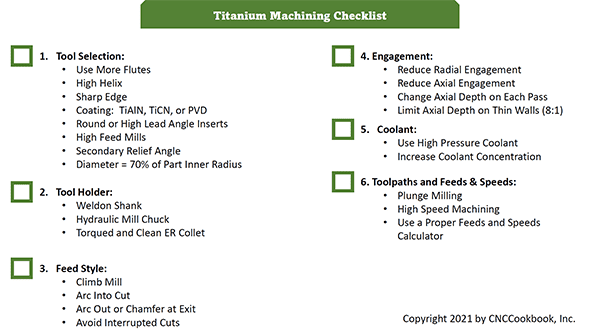

Conclusion:  Plan Ahead and Be Systematic and You’ve Got This
Whoa!  That’s a lot to remember!
Wait.  You’ve got this.  You know what you need to do, how to pick the right tooling, and how to use that tooling.  You know why, what the obstacles are that titanium applications must overcome.
The fact that there are a lot of steps just means you need to plan ahead and be systematic when machining titanium.  Keep a checklist for titanium jobs and make sure you’re employing every strategy.  Soon enough that checklist will be second nature.
But, until it is, it will get you through the problems and pitfalls.
titanium machining checklist
You’ve got this.
