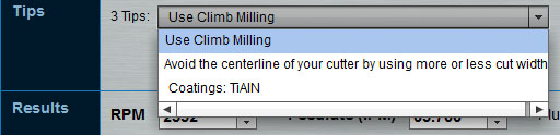

BTW, I mentioned above that a good Feeds and Speeds Calculator will keep track of qualitative tips, like this one. If you read tooling catalogs as much as I do, you'll know that there are hundreds if not thousands of such tips. Who can remember all of them when it's time to program a part? Nobody can, even experienced machinists are lucky to remember a fraction of them all.
But we've built our G-Wizard Calculator so it will remember these tips for you and present them at exactly the time when they can do the most good. Take this tip to avoid putting the cutter on the centerline. There's a warning in G-Wizard about that:
Typical Tips from G-Wizard: Avoid the centerline, use climb milling, and TiAlN is the best tool coating for this material...

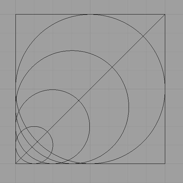

Trochoidal Milling was first introduced to clear slots. Imagine rolling a disc in a straight line along its edge, with a pencil stuck in the side of the disc. The tip of the pencil describes a looping figure called a "Trochoid" as it rolls. Now imagine cutting a slot with an endmill. Normally, the endmill just plows along the slow, full width. But suppose you used a smaller endmill, and suppose you made it loop around and around so that the loops were the full slot width. That's a Trochoidal Toolpath, and you can run it a lot faster than you can run the full width endmill.

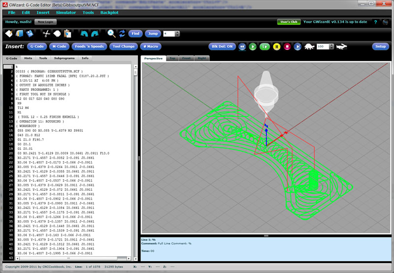

Constant Engagement Angles
The problem with Peeling and Trochoids is they're special case "hacks" for corners rather than general purpose ways of controlling tool engagement angle. Eventually, CAM vendors solved the problem of how to generally create toolpaths that keep constant tool engagement angles. The productivity when roughing with such paths is huge. Here is a typical path created by GibbsCAM's Volumill for a pocket:
Constant Engagement Angle Path as displayed by G-Wizard Editor...

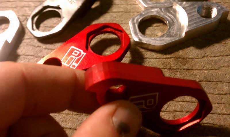

Another Take on Artifacts: Facets from STL
It's good to have a lot of choices for file formats and to know what the different formats strengths and weaknesses are. Depending on the job, some are better than others. Consider this part which is showing marked faceting where there should be smooth curves:
Faceting shows the G-code used lines where arcs might have been better...
The photo is from a CNCZone thread. The machinist had recently switched from using the DXF format for CAD to STL files. That's when the faceting began. The trouble is the STL file format has no way to represent a smooth curve or even arcs. It converts everything into triangles:
An STL mesh from MeshFlatten software...
There's not necessarily anything wrong with this, except that you have to be aware of it. Your CAD and CAM software will allow you to specify the tolerances-how closely must the mesh match the idealized 3D part? With a small enough tolerance, the facets will disappear. The flip side is unless your CAM software is pretty clever, you'll be forcing your machine to make hundreds or even thousands of tiny little straightline moves for those facets. A clever CAM will spot the opportunity to use arcs to simplify the code. You can even purchase software that goes back into your G-code and looks for opportunities to substitute arcs.
The thing is, with this particular part, the desired result is very amenable to 2 1/2D programming. STL is more of a 3D format. Why go crazy profiling a bunch of triangular facets in 3D when you can just cut a simple profile with arcs and line segments in 2 1/2D?
