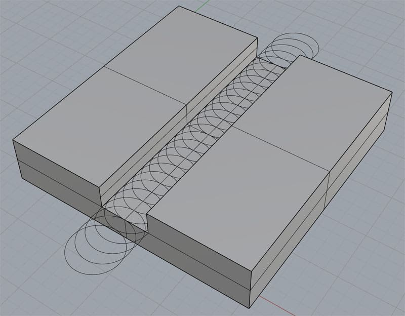

Trochoidal Milling is a High Speed Machining (HSM) technique that moves the cutting tool in a shape called a “Trochoid.”  The link shows the derivation of what a Trochoid is, but here’s a typical Trochoidal Tool Path for slot milling:
TrochoidalMilling
Using Trochoidal Milling for slot milling…
The idea is each cut consists of continuous spiral tool paths rather than moving down the slot in a straight line as you would with Conventional Milling.  The advantage of Trochoidal Milling is it keeps a constant load on the cutting tool so you can run higher feeds and speeds.  Some Trochoidal paths create a more “D” shaped tool path and don’t do a complete circle each time, which can be faster than the full circles.
Here’s what we mean by keeping a constant load on the cutter.  The load is determined by how much of the circumference of the cutter is involved in the cut, also called the “engagement angle”.  Constant Load tool paths have Constant Engagement Angles.  Conventional Toolpaths have much higher loads in corners.  You can see that graphically via this illustration:
tool cutter engagement angle
See how engagement increases dramatically as the cutter goes into a corner…
While some refer to all HSM constant engagement tool paths as “Trochoidal”, the term specifically relates to paths that follow the continuous spiral tool paths shown in the first diagram.  As such, Trochoidal Milling is most commonly used to cut slots.

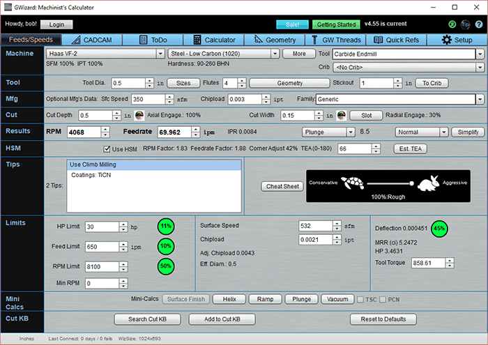

Actually, it’s pretty simple.  Here is one all set up:
trochoidal milling feeds and speeds calculator
Feeds and Speeds for a Trochoidal Milling operation to cut a slot…

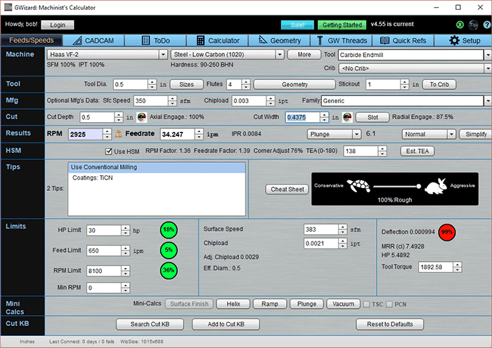

First, you set up the machine, material and tool.  We’re cutting some mild steel with a 1/2″ 4 flute carbide endmill.
Next, you need to tell it the cutting conditions.  We’re doing a 1/2″ deep slot, so I went with a full 1/2″ of cut depth.  Our cut width, radial depth of cut, or stepover is important because it governs how much we can accelerate due to High Speed Machining.  The less of the tool that’s in the cut, due to smaller stepover, the faster we can go.  But there’s a tradeoff.  If you make the radial depth of cut too small, the cutter goes spinning through the material crazy fast but it doesn’t accomplish all that much and the MRR falls.  Most authorities suggest 10-30% of tool diameter as a good starting point.  You can fiddle with it from there, keeping an eye on the MRR, until you find a value that suits your needs.  For this example, I chose a 30% stepover, or 0.150″.
Okay, the last step is to turn on the HSM Feeds and Speeds feature of G-Wizard.  Just click the “Use HSM Feeds and Speeds” checkbox and your Feeds and Speeds are updated.  We can see an RPM Factor and a Feedrate Factor that are each close to 2.  That means that since we can guarantee this is an HSM tool path that will keep a constant TEA, both the RPM and the Feedrate can be bumped up to nearly 2 times the conventional feedrates.
Wow!  Those HSM toolpaths move right along, don’t they?  For more on Feeds and Speeds for HSM Machining, try our Feeds and Speeds Tutorial chapter on HSM.  In this case, we’re getting an MRR of 5.2 cubic inches of material per minute and running about 3.5 Horsepower into the cut.

That’s a conventional Feeds and Speeds Calculation of Trochoidal Milling, but G-Wizard can do an even better job for you using a feature called “Cut Optimizer”.  The idea behind “Cut Optimizer” is to find the maximum width of cut (or depth of cut, or feedrate, it’s multipurpose) that can be used without too much Tool Deflection.  This feature is unique to G-Wizard, you can’t get it elsewhere, and it sure is powerful.
NoteHere’s a full article on how to optimize your Depth of Cut and Stepover for CNC Milling.
While many authorities tell you as I mentioned to use 10-30% of diameter for stepover, check out what happens when we use the Cut Optimizer to maximize our stepover:
optimizing trochoidal milling feeds and speeds
We’ve pushed the Cut Width up to 0.4375, which is 87.5% of diameter.  As a result, or Material Removal Rate is now 7.4928 and we’re using about 5.5 spindle horsepower.
Why is this much higher stepover outperforming the recommended 10-30% stepover numbers?
Here’s the thing:
We can go faster with an HSM toolpath because we aren’t slamming into any corners that shock the tool.  But that says little about stepover.  The role of reduced stepover is twofold.  First, it unshrouds the flutes of the cutter so chips can be flung out of the cut radially–they don’t have to be carried up and out by the helix.  Second, we give the flutes more time exposed to air instead of cut, and they get a chance to cool off a bit.
But there’s a trade-off.  Those advantages are traded off against the fact that we’re cutting less material per revolution with lower stepovers.  What G-Wizard has done here is found a sweeter spot than the usual recommendations.
