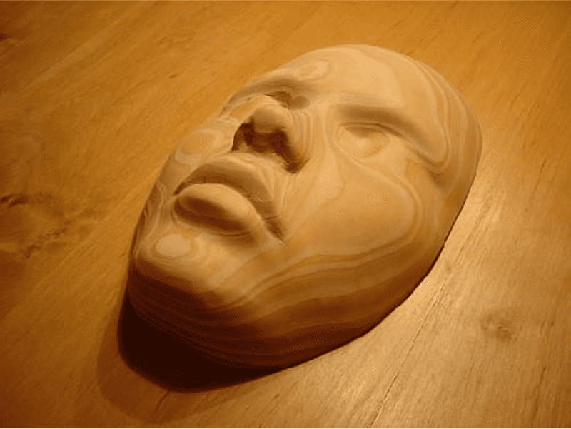

CAM Toolpaths and Operations have a lot in common with sculpture
CAM Programming is the process of using CAM Toolpaths and Operations to set your part free from the block of material it resides in.
When asked about his statue of David, Michelangelo said, “I saw the angel in the marble and carved until I set him free.”
Much the same could be said of what goes on when using CAM software.  You’ve got a piece of raw stock, perhaps a block of 6061 aluminum.  You have a vision of the part that needs to be made in the form of a CAD model or drawing.  The task of CAM software is to carve the block until you have set your part free.
This is typically done by selecting various CAM Operations or Toolpaths.
An Operation or Toolpath is typically aimed at machining a particular Feature on the part, and we often refer to the Toolpath and the Feature by the same name, such as a “Hole” or a “Pocket”.  But not always–“2D Profiling” cuts “Vertical Walls” around the outside of a part, for example.
This article is all about teaching you what those Operations and Toolpaths are so you’ll have an idea of how to go about choosing them as you use your CAM Software.  They’re also very useful for thinking about Feeds and Speeds (our G-Wizard Calculator’s CADCAM Wizards are built around toolpaths) and CNC Job Quoting (our G-Wizard Estimator also uses the same CADCAM Wizards for job estimation and quoting so the results match what you’ll get on your Shop Floor).

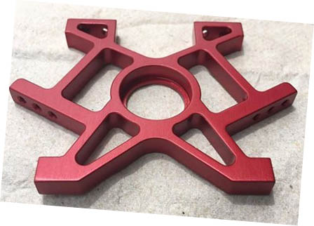

2 1/2D, 2.5D, or Prismatic Parts vs True 3D Machining

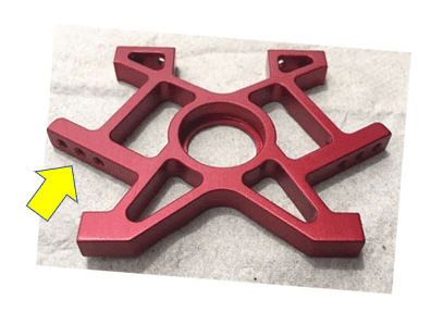

The vast majority of parts made on CNC Machines, at least on Milling Machines and Routers, are what’s called 2 1/2D, 2.5D, or Prismatic Parts.
They’re 3D parts to be sure–we live in a 3D world after all.  But, cutting movement, with the exception of holes, happens mostly in X and Y, with a constant Z value.  The walls of Prismatic Parts are vertical unless tapered cutters were used.  And curves are strictly in X and Y, so no convex or concave curves happen on the face of the part.  Here is a typical Prismatic part:
A typical prismatic part.  Note the vertical walls.
Parts are shaped this way because they go together in mechanical assemblies.  Having square faces and walls makes it easier to fit them together.  By contrast, here is a part that has curved surfaces and is therefore not a Prismatic part:
The 3D part is more organic.  This one is perhaps an exaggeration to make to point, but you get the idea how different these two kinds of parts are.  Hence they use quite different CAM Toolpaths and Operations.

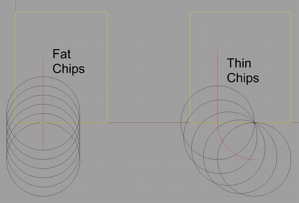

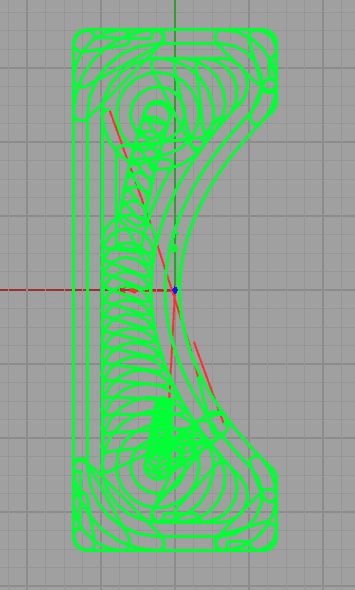

High Speed Machining, Trochoidal Paths, Corner Peeling, and Adaptive Clearing
A huge revolution in Pocketing Toolpaths came with the advent of High Speed Machining Toolpaths.  See our article for full details here:
[ High Speed Machining, Trochoidal Milling, and HSM Speeds and Feeds ]
HSM Toolpaths are MUCH faster than Constant Stepover because they maintain Constant Tool Engagement.  Some really tricky moves mean that cutters don’t suddenly dive into corners and cutting forces are equalized everywhere on the Toolpath.  Because of that, we can run faster because we’re not shocking the cutter with sudden huge increases in cutting forces.
These toolpaths have a distinctive appearance that is filled with seemingly randome curly cues and arcs:
Weird, right?  Yet these Toolpaths can be WAY faster.  They can also be tricky to optimize on both feeds and speeds and the tradeoffs of Cut Width and Cut Depth.  Our G-Wizard Calculator will do that optimization for you, and it has helped many CNC’ers to cut faster and with better tool life.

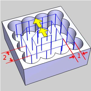

Plunge Milling: Secret Weapon for Lighter Machines and Rigidity Challenges
Plunge Milling Roughing a Pocket
Plunge Milling a Pocket – Image courtesy of BobCAD
As great as HSM Toolpaths are, there’s another Toolpath that is sometimes better.  It’s called Plunge Milling, and it involved plunging straight down to open up a pocket with a series of holes.  It’s greatest advantage is that the rigidity of machines and tools is greatest in the direction of the spindle’s axis.  Plunge Milling focuses cutting forces where the machine and tool are strongest.  If you have a lighter CNC machine, or other rigidity challenges (tiny corners in a deep pocket requiring a small diameter tool), this toolpath can really help.
Check our article for more details:
[ Plunge Milling / Roughing: CNC Secret Weapon ]

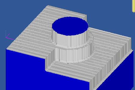

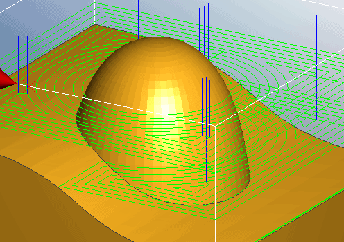

3D Profiling
Offset Roughing a 3D Surface…
Simulation shows the resulting stair step will have to be made smooth in the finishing pass…
There are many different Toolpaths, both general and specialized, for 3D Profiling.  Some are completely unique to the 3D Profiling world.  Some borrow a bit from their 2D cousins, for example, Adaptive 3D Clearing allows HSM toolpaths for 3D Profiling.
When doing 3D Profiling it is even more important to break roughing and finishing into two different operations, and choose appropriate Toolpaths and their parameters for each.  Roughing is all about removing the majority of the material as quickly as possible, but what it leaves behind may not resemble the finished work very much.  See the stair step above from a 3D roughing pass.
Finishing is all about getting as close to the ideal surface as is needed.

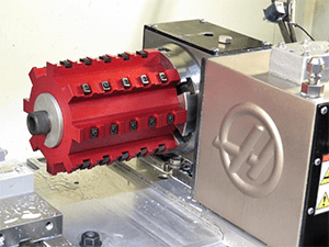

Face Milling or Surfacing
This operation simply mills a surface flat, typically with a Face Mill or perhaps a Fly Cutter.  There are variations in how the full surface is covered:
  • Spiral In/Out
  • Zig Zag back and forth
  • Climb Mill Only
What can be really key when Face Milling is how the cut is entered, especially for tough materials like Stainless Steel or Titanium.  You want to arc into these cuts like so:

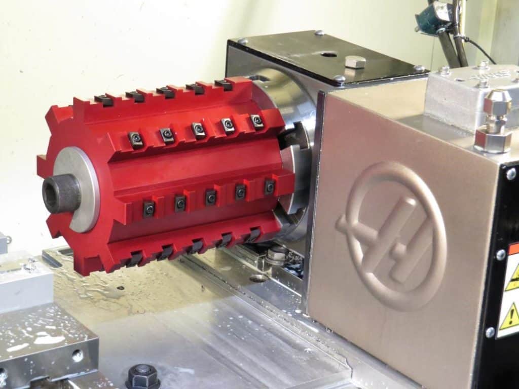

4th Axis Toolpaths
Let’s talk about the 3 major categories of 4 Axis Toolpaths and Operations:
Indexing
Indexing is not a Toolpath, because no cutting is done during Indexing.  But it is a CAM Operation.
With Indexing, the 4th Axis rotates to give the spindle access to another side of the part, or perhaps, to access more parts.
4th Axis Wrapping
4th Axis Wrapping is the simplest kind of 4 Axis Toolpath.  Imagine a Prismatic Part that is cutting shapes on a flat plane.  Now wrap that plane around a 4th axis to create a cylinder.  Lastly, imagine a Toolpath that follows the wrapped 2 1/2D Toolpath around that cylinder.  Now you’ve got 4th Axis Wrapping.
It’s pretty simple, but can be quite useful for some applications.

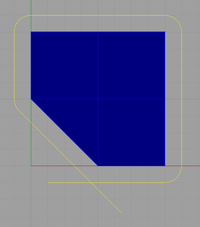

Toolpath Entry Methods
How the cutter enters the cut is crucial to tool life and surface finish, especially in hard or difficult materials like stainless steel or titanium.  Lots of entry options are available in the most full featured CAM packages.  Ramping down is one of the most common.  Where possible, avoid entering cuts with a plunge.
Here’s a tip for entering a 2D profile.  Follow a path like this and there will be fewer tool marks in the wall of your part:

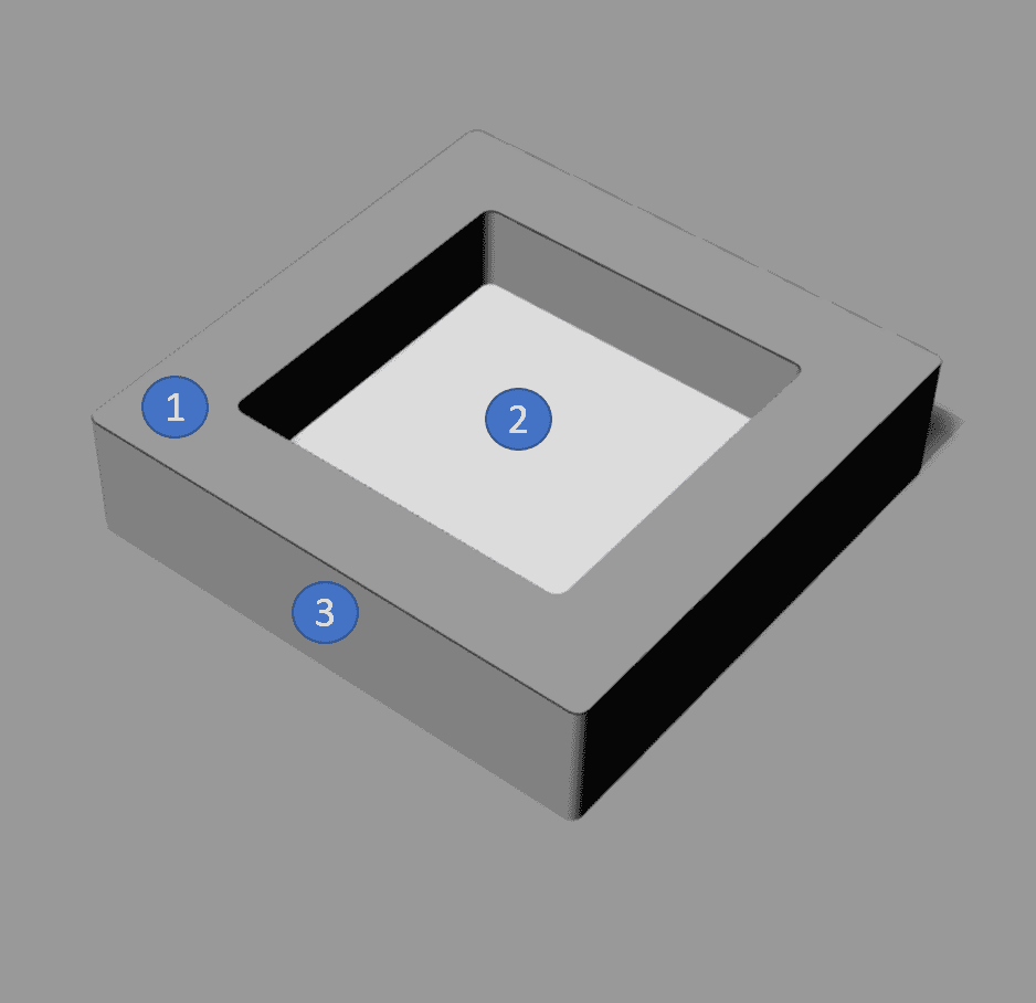

Paperclip Bin
Here’s a very simple part, a Paperclip Bin for your desk:
I look at that part and I can identify 3 features (one of which has to be done twice):
  1. Face Mill the top surface.  When all the other features are done, flip the part upside down and Face Mill the bottom.
  2. Pocket.  This is a classic pocket.  The radius of the inside corners will determine how large an end mill we can use to do the pocketing, at least the finish pass.  If we have Rest Machining, we can remove most of the material with a bigger end mill and then get down into those corners on a later finish pass.
  3. 2D Profiling is the toolpath we’ll use to finish the outside wall of the part.
Note that we’re also like to want to run Chamfer Toolpaths around all of the edges of the part.  I haven’t shown that hear, because it is sometimes an option for Pockets and 2D Profiling, and sometimes you have to program it as a separate Toolpath.
