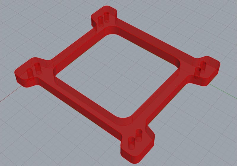

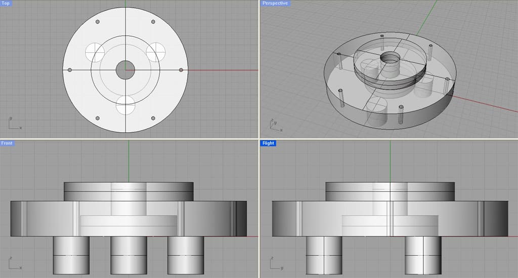

In addition, I recommend you try to draw at least 3 or 4 of the same parts in each package you're evaluating. That can help make the comparisons more Apples-to-Apples. Pick something simple to start with. Here's the first part I ever drew in a CAD package:
It's hard to tell, but it's a backplate for a lathe chuck. It's just complicated enough to be a real example, but there aren't so many different features on the drawing that it takes forever to learn how to do. An even simpler part would be this 4-barrel carburetor spacer plate:
That one comes from my article "Secrets of Going From CAD, Image, DXF, or STL to GCode for CNC and 3D Printing".

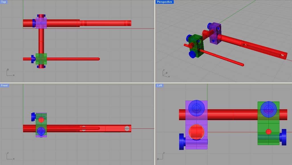

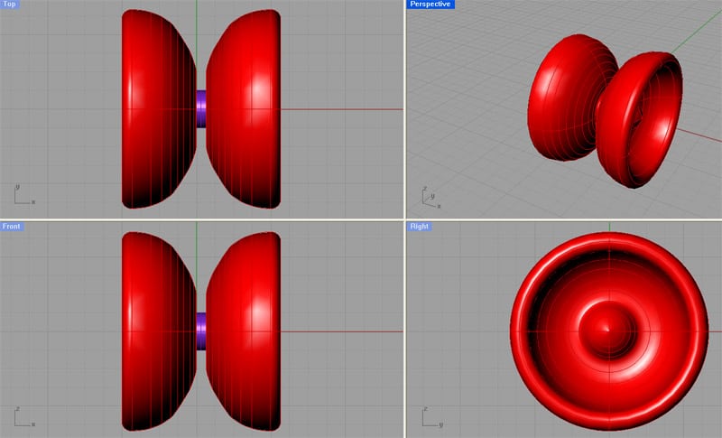

You should also draw something that requires multiple components. This is what the CAD world calls an "Assembly", and it's something you'll wind up doing a lot. Here are some simple assemblies I've drawn:
YoYo's can be awesome CNC projects!
More into tooling? Here's a vise stop I made that's been a great help around the shop...
If you can draw all of those in each CAD package you're evaluating (or similar things you want to draw), you've done your homework.

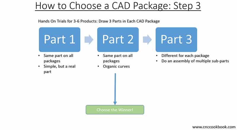

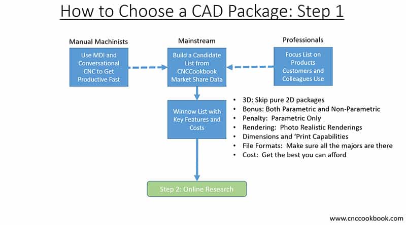

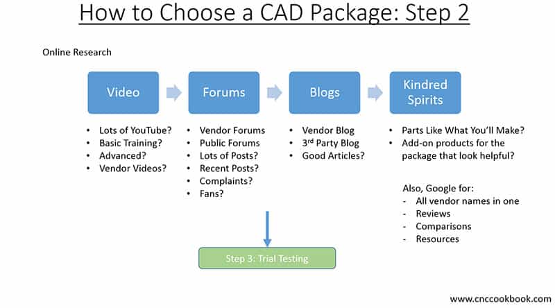

Here's a pictorial guide if you want a detailed and deep process for choosing your CAD software:
Step 1: Build Your Candidate List...
Step 2: Do your online research...
Step 3: Hands-on Testing. Draw 3 parts in each CAD package to see which one is best for you...
Now ask yourself, "Which one was the easiest to learn?" And also, "Which one feels more natural so that I'd like to keep right on using it?"
In all likelihood, one of the packages will stand out from the others. Your choice will probably not be the same as your buddy's choice or the choice of the gang in the online Machinist's Board talking about CAD. That's fine. We all have different styles. The important thing is to choose the software that's best for you!
