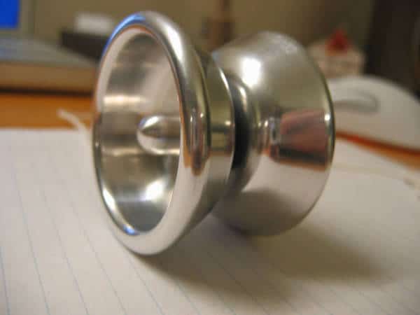

I confess, this one has been on my mind ever since I came across an article about CNC’ing Yoyos back in 2006 on Practical Machinist. Here is the YoYo from that article:
The CNC’d YoYo that caught my eye…

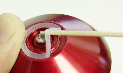

High Performance Response Pads
The friction is so low with a bearing hub that there’s nothing for the string to grab to make the YoYo come back up unless you install a response pad:
Response Pad: Silicone rubber pad is glued down in a groove around the bearing…

I actually have a prototype of something very similar, just a different size and material. Interesting!
Thanks for your post. I’ve always loved YoYo’s since I was a kid. Here are some links to one I made a few years ago. It features a bronze ring to help the flywheel effect.
http://frankieflood.blogspot.com/2012/01/yo-yo-machined.html
http://frankieflood.blogspot.com/2012/01/yoyoyo.html
