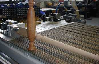

Most 4th Axis woodworking is about continuous indexing in order to do round work such as engraved cylinders of columns for various kinds for architectural work:
This sort of thing is called ornamental turning work, and in fact, it is common to refer to the 4th Axis as a “Lathe Attachment” in the CNC Router world.

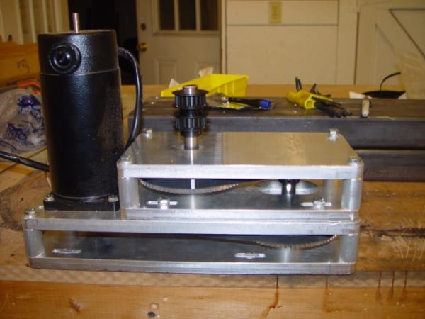

CNCZone has some neat pictures of a DIY lathe attachment for a CNC Router:
His solution for low backlash gear reduction was to build a “gearbox” using timing pulleys to slow down his stepper motors. Clever!
