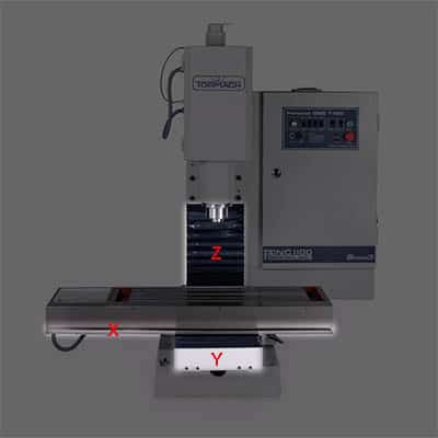

Large gray CNC milling machine with multiple axes.
A CNC Milling's Axes are attached to the Machine Frame.  Their role is to provide motorized motion in each dimension as commanded by the control panel or g-code program through the controller.

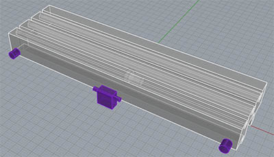

3 Axis CNC
A typical 3 Axis CNC Milling Machine has it's axes arranged something like this:
A 3D graphic of a mill axis system, featuring a cylindrical object with arrows indicating x, y, and z axes.
3 Axis CNC...

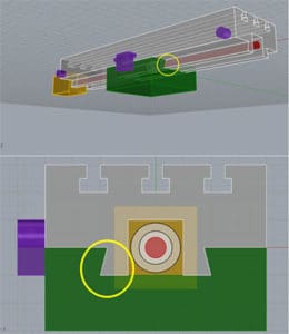

In order to satisfy its function, each CNC Axis has the following components:
Table saw diagram, including motor, ways, switch, leadscrew.
Let's get a closer look at each component and learn more.  We won't bother with the table here as not every axis has a table and we already covered CNC Milling Machine Tables.
CNC milling machine linear motion components, X and Y axes, Z-axis visible.
CNC Milling Machine Ways
CNC Milling Machine Ways provide a low friction precision sliding surface.  Their job is to guide the motion so it is properly aligned to the axis and keep things moving freely and precisely.

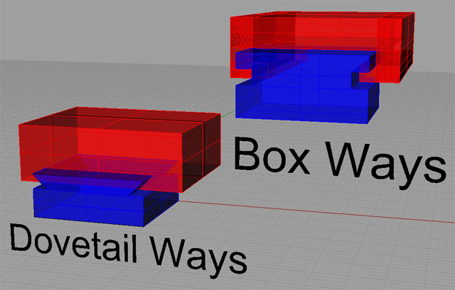

Box Ways / Dovetail Ways
The diagram on the left depicts what are called Box Ways, and these Box Ways in particular are Dovetail Ways because the surface is like a dovetail joint from woodworking.  Other shapes besides the dovetail are possible, such as the more rectangular shape depicted here:
Dovetail ways and box ways in metal fabrication.
Box Ways are most commonly made of cast iron because it has good properties in terms of metal-on-metal sliding contact.  Other kinds of metals such as aluminum are not so good because they have a tendency to gall.

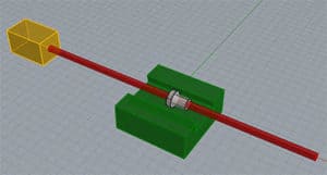

Red leadscrew with yellow nut and green blocks.
Leadscrew
The Leadscrew converts the rotary motion of the motion to linear motion.  Other CNC Machines such as CNC Routers and Plasma Cutters may use alternatives to a leadscrew, such as belt or rack and pinion drives, but for CNC Milling Machines a Leadscrew is the most common solution.
The Leadscrew must convert rotary to linear motion with as little friction as possible and as little backlash as possible.

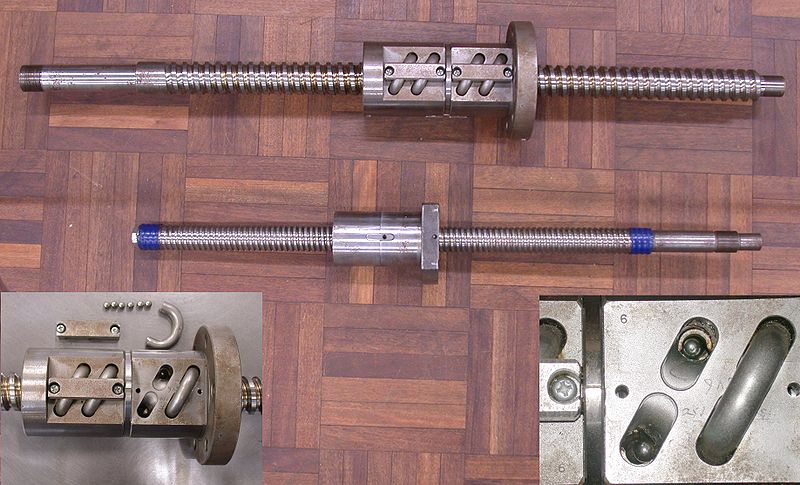

Ballscrews
Ballscrews are the ideal leadscrew for CNC because they minimize backlash and friction to the highest degree possible.  They're called "ballscrews" because the circulate ball bearings in the ballnut.  The ball bearings ride in a groove on the ballscrew, and it's the use of ball bearings that makes the high precision, low backlash, and low friction possible.
Here's a typical ballscrew and ballnuts:
A ball screw, a machine component with a threaded shaft and rotating nut converting rotary motion into linear motion.
The little pieces of tubing return the ball bearings to the top of the nut once they've travelled to the bottom.

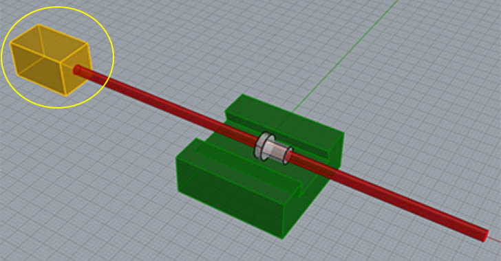

A 3D rendering of a milling machine motor with green base, red shaft, and yellow cube.

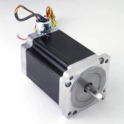

Motor
Black rectangular object with silver metal plate and cylindrical protrusion.
Stepper motor for a CNC Milling Machine...
The photo above shows a typical Stepper Motor for a CNC Milling Machine.  Stepper Motors are called that because they're designed to move in discrete steps.  A typical stepper motor can move in 200 steps per revolution; about 1.4 degrees per step.
Notice that this particular motor pictured has a waterproof connection.  That's important if your machine will ever have flood coolant-coolant and electrics just don't mix very well.

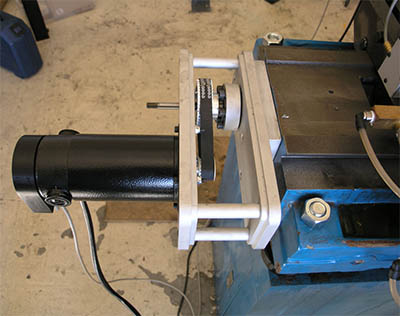

Stepper Motors are the most common motor for DIY CNC Projects, but most commercial CNCs, at least the industrial-quality ones, use Servo Motors.
Here's a Servo Motor I used on my project to convert an RF-45 mill to CNC:
Servo motor, possibly for robotic or CNC machining use.
Servo Motor with belt drive...
What's the difference between a Servo and a Stepper Motor?
The primary difference is that Servo Motors are Closed Loop while Stepper Motors are Open Loop.
A Servo Motor has a device called an Encoder attached.  You can see it in the photo as the little black box on the back of the servo that has a gray cable connected to it.

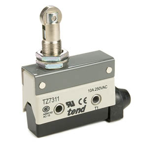

Home & Limit Switches
Silver limit switch with black base and three holes.
Home / Limit Switch for a CNC Milling Machine...
Home / Limit Switches tell the CNC Milling Machine when it has reached the limit of travel for the axis.  The two names imply two purposes:
For most machines, only one switch is used per axis, and it's a Home switch.  The Limits are determined in software.
The first thing you want to do with most CNC Machines when you turn them on in the morning is to "Home" them.  This means the machine moves to trigger the home switch on each axis so it knows exactly where zero is on that axis.
There's a little fly in that ointment though, especially with the sort of Home / Limit switches used by DIY CNC'ers and on lower end machines.  That fly is the repeatability of the switch.
Repeatability means if you repeatedly home an axis, how close does it stop at exactly the same point.  You might think it'd be perfect every time, but it's really not.  In fact, at the low end, it is so far from perfect that it becomes a problem.
A switch like the one pictured is only accurate to a few thousandths of an inch.  Let's say it's +/- 0.005" each time.
Why is that a problem?
Suppose you're working on a job and decide to go to bed.  You turn the machine off.  Next morning you restart.  The machine may be off by up to 0.005" from where it was when you quit.  That's quite a big error in CNC Machinist terms.
What this forces you to do is manually rezero the machine with an edge finder or other probe.
Having to do this is not the end of the world, but it's a nuisance and the time consumed costs money for a professional shop.
Much higher accuracy is possible with better switches.  Most Commercial CNC Milling Machines use Servos, and they emply the high accuracy of the servo's encoder to radically improve the accuracy of the mechanical switch.
It's nice to walk up to a CNC machine, turn it on, home it, and be ready to keep going on the same job with plenty of accuracy!
