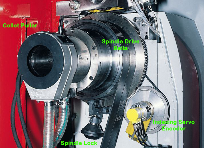

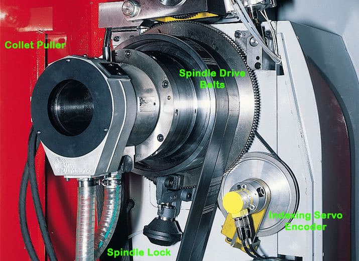

Another approach is to use a secondary servo that may be engaged or disengaged. Here is such a setup on an Emco lathe:
Lathe C-Axis Mechanicals…
We can see a number of interesting functions from the photo:
– There is a collet pulling mechanism to open or close the collet or chuck.
– There is a toothed gear and hydraulic spindle lock. Considerable side force can be applied during C-Axis operations and it is often important to be able to lock the axis while that happens.
– The spindle is driven by a couple of large multi-groove belts.
– There is an auxilliary spindle indexing servo. It’s not visible in the photo, but it’s encoder (or possibly a transmission to engage/disengage it) as well as the cog belt system it uses to drive the main spindle are there.
