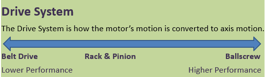

Typically, a rack and pinion drive system would be compared against belt drive at the lower end and ballscrews at the higher end.
