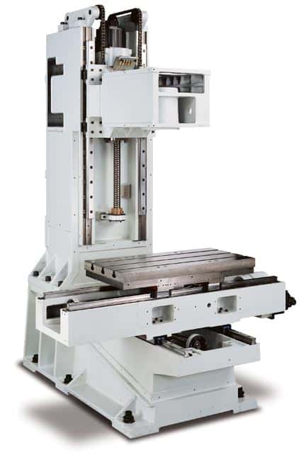

Most commercial VMC’s use one. Here’s a Hurco VM1:
Twin roller changes connect the Hurco VM1’s Z-Axis counterbalance…

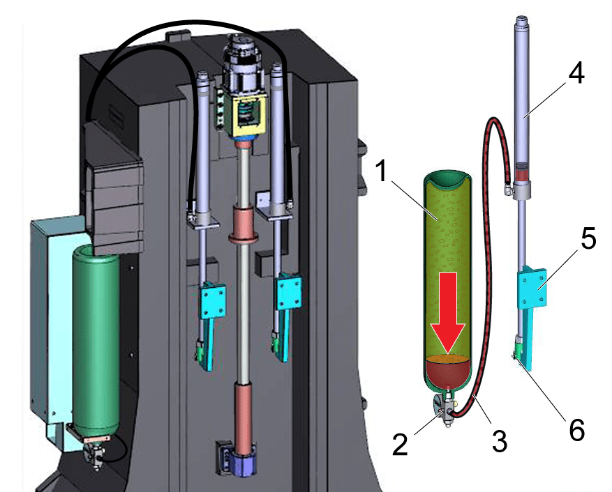

Or, here’s a schematic from the DIY Haas site showing how Haas uses an air-over-oil system as a counterbalance:
Air-over-oil hydraulic Z-axis counterbalance on a Haas VMC (courtesy DIY Haas)…
Using an air-over-oil system keeps the counterbalance system more compact.

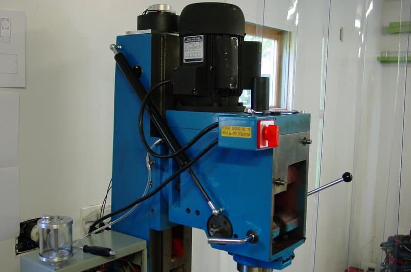

For small CNC Machines, gas springs can be an ideal solution. Here is a typical gas spring installation:
Z-Axis counterbalance using gas springs…
Gas springs are nice and compact, which can make it easier to find room to install them. You can have them act directly on the Z-axis as shown above or use a cable or counterbalance arrangement to transfer forces to the back of the column.
Something to be aware of is that when you cantilever them directly as in the photo, you want to minimize the angle of the cantilever and think about exactly where the force is being directed. A larger cantilever angle causes the forces to vary as the head moves up and down, which is hardly ideal as the force of gravity won’t vary so the spring’s force is either too much or too little.
Also, the angle the force is directed can create a tendency for the head to cock against the ways, which can reduce the accuracy and increase the force necessary to move the head up or down.
You’ll have more flexibility in your design to avoid these problems with a roller chain or cable linkage.
