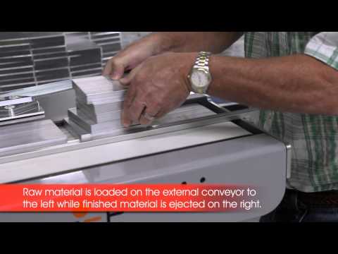

There are a lot of approaches to reducing the amount of time spent in setup and similar operations, and this product certainly seems like it might contribute some savings. The intent was to create a non-robotic and easily programmed system that loads and unloads the machine vise on your table with a simple conveyor belt. The inventor, Steve Simons of Simons Design Innovation, wanted to get away from having to have a robotic arm. The product is called the Smart Valet SV-1. Here’s a video of one in operation:
[youtube]http://www.youtube.com/watch?v=DK9cG6911LI[/youtube]
As you can see, the conveyor rolls a new workpiece onto the vise, the vise clamps, the part is machined, and then a little arm comes up under the workpiece and yanks it back into the Smart Valet. It can be programmed to automatically stop when it runs out of material. As Simons says, “It’s like having a bar feed for your VMC.”
